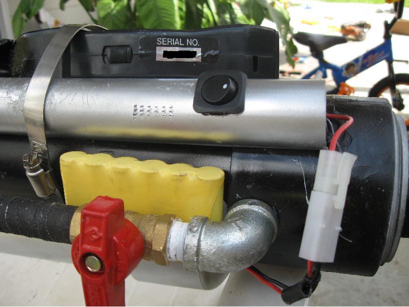

Grip tape is wrapped around the barrel for easy removal for breech loading. It is also wrapped around the end cap and handle. A rechargeable battery is used to operate the fan and is held on to the chamber with velcro. All wires are housed in the handle, which is made of 1" Sch40 and two 45 degree elbows. The propane tank holder is mounted directly under the chamber to even out the balance. It is finished up with black and silver paint.

fan switch and rechargeable battery

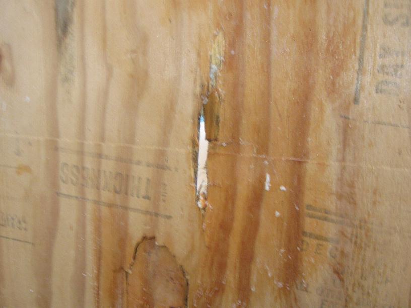

half inch thick plywood versus a potato
back of plywood (after three shots)

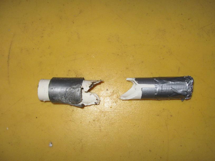

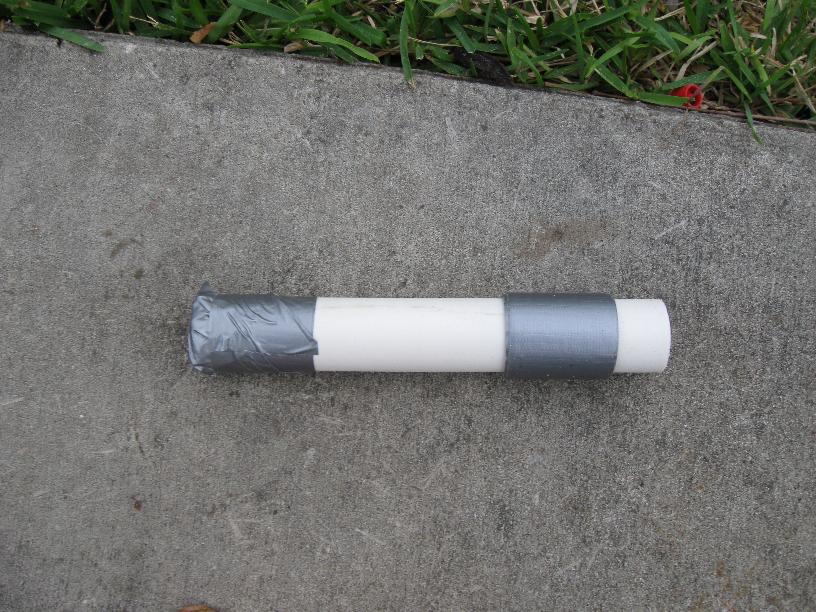

homemade "dart"
homemade "dart"

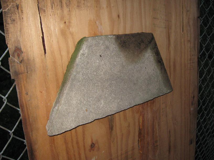

1 inch thick cement
1 inch thick cement
dart after impact with cement
cement after impact with dart

Yessir, i like. Clean chamber innards and the rechargable battery pack... nice touch.
What are you holding your tank in the pipe with? Magnets?

Actually, I considered a magnet but I cut slits and ran the hose clamps through the tank holder. The friction from hose clamps passing through the holder holds it in just fine.

Nice build! Does your plywood have panaling on one side? Would have been sweet to get a video of that dart destroying that concrete, WHAM! What did that sound like when it hit? I also like your paint scheme, simple. Looks good I think.

The battery pack powers the stungun too right?

The plywood did have paneling on it. It came off the side of my house when I put a new siding on it. It was also painted, which just added to the back shot.
biggsauce: The battery pack just controls the fan. The stun gun has it's own battery compartment.

Nice ingenuity, I like how the fan is held in by the spark strip body and is removable with it.
So is that a 9v battery pack? If so I'm assuming that is a 12v fan....
How does 9v get it going for you?

The battery pack came from an airsoft rifle I had. I'm not sure on the voltage, but it is enough to run the fan and does so quite well.
I'm dropping the stun gun from it. Because of the removable spark strip, I am trying to install an electric grill igniter, which will run off of the same rechargeable battery. A downgrade, I know, but it works and I need the stun gun for my hybrid, which is going through a makeover as well (I want to put a golf ball through some stuff :wink: ).

sweet weapon, looks like a powerhouse, i like it. btw the battery pack looks like maybe about 9 volts. i powered up a couple 12 v pc fans i want to use in one of my guns with 9 volts but they spin kinda slow, do u have this problem?

The only time the fan spins slow is when the battery drains. Otherwise, I can't really tell a difference in spinning 9v versus 12v.
