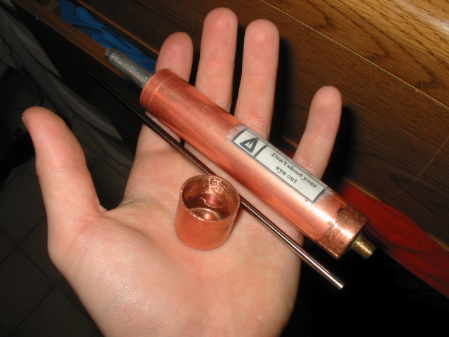

This is my 5mm Marker gun it uses 4.5mm bbs with a little wadding it can shoot through 2 sheets of bristel board. This gun has a 5mm 4'' long aluminum barrel.The body of the gun is 3/4'' type M copper pipe which is 4.5'' long. The piston is 3/4'' wide by about 3/4'' long this is piloted by a shrader valve. All parts are epoxied in.

Marker gun, Ramrod, and shrader protector cap aka ''safety''

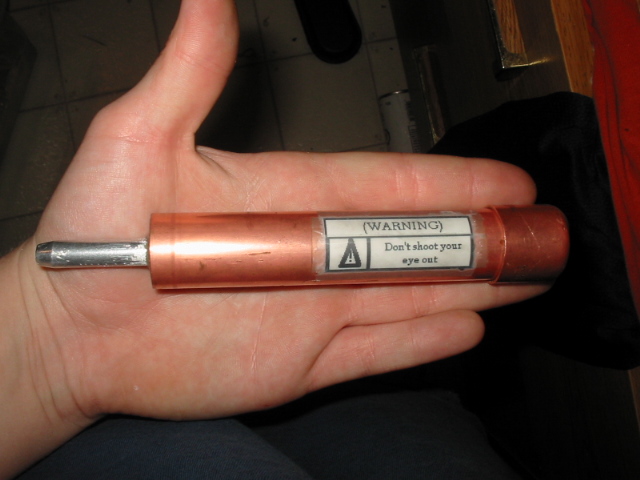

Marker gun is the lenth of my hand.

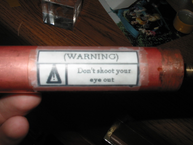

Warning don't shoot your eye out.

Love the whole Christmas Story theme warning sticker. What pressure do you run at?

To tell you the truth I don't know I don't know where to get a high pressure guage for my shock pump so I don't know but it is 300psi or more definently. here is the little lable I did up on ms paint...
You can print it for minis if you want to.

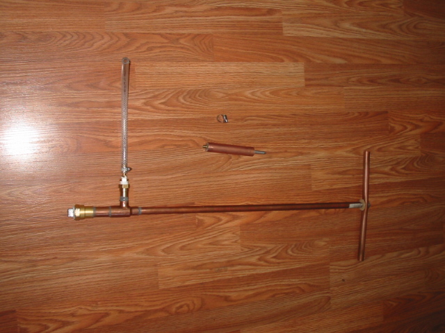

I am also thinking of putting a endcap with a hole in it on the piece of pipe that goes into the 1/2''x1/2''x3/4'' tee so that the pipe doesn't slice into the piston sealling face did I mention that my pump is similar to btbs pump? I think that is what got him in the face the sealling face was sliced into. This way my pump could get to higher pressures.
EDIT: God damn it I double posted again sorry MC.
My pump.
My pump.
