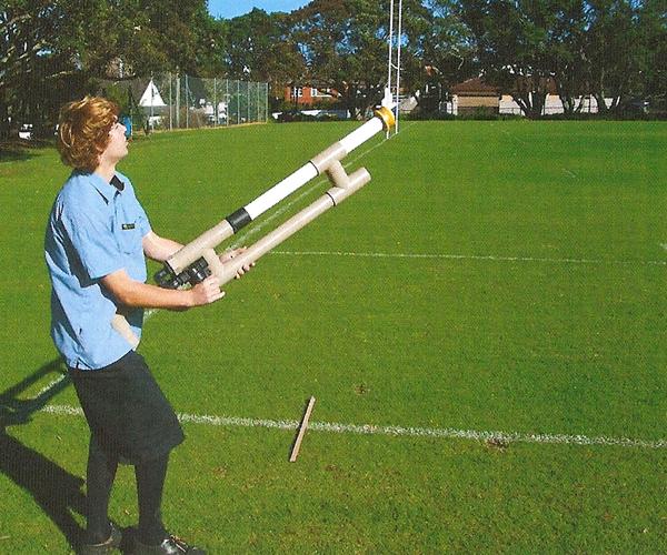

Here's one of the pictures my 'range finders' took of me for proof that it works... :)
