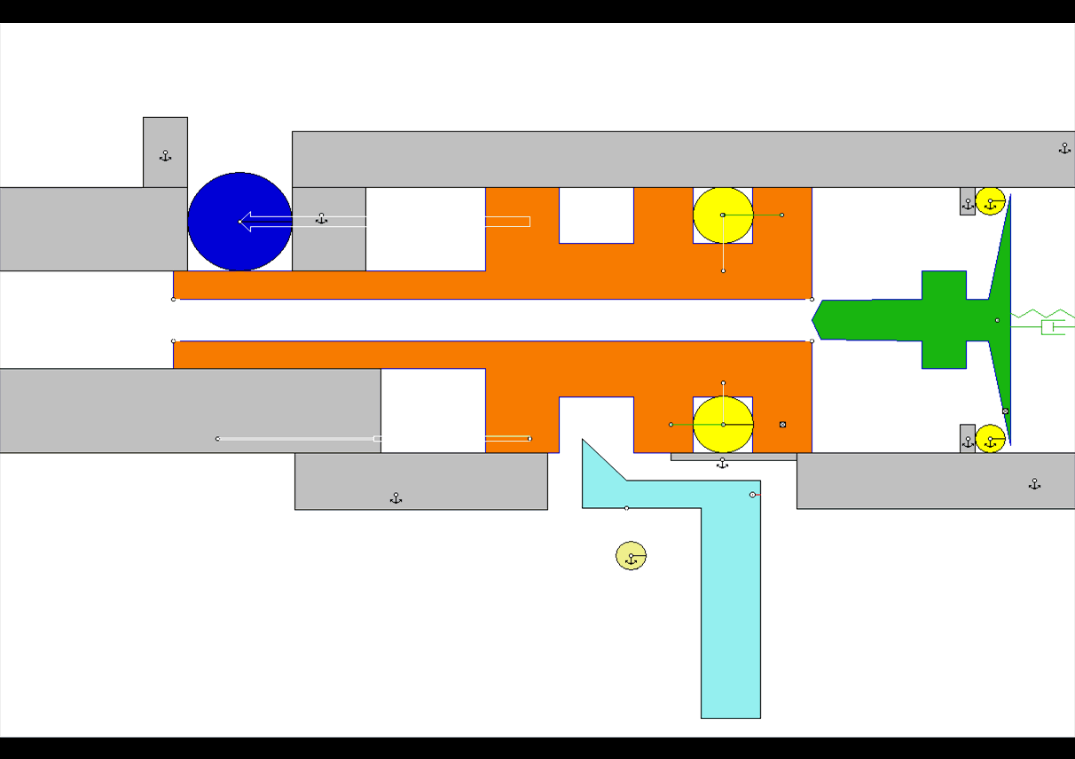

At the moment I am working on a prototype of this idea:
I know Jack has tested it as well, but I think this design is promising as there are not that many moving parts. I'll post an updated animation soon:)

ant wrote:I know Jack has tested it as well, but I think this design is promising as there are not that many moving parts.
I had illustrated the concept but didn't actually make a prototype so the ball's in your court. The theory seems to be sound, all we need is for someone to make it work, and I'd say you've got the right credentials ;)

The animation I made some time ago.
The yellow circles are O-rings btw

I think that it's hard to get a good seal between the hammer and the valve stem, but it's always worth trying :D

It certainly looks good in theory, are you going to try it out?

jackssmirkingrevenge wrote:It certainly looks good in theory, are you going to try it out?
Yeah for sure! I finally have vacation now... jaaaaaaaaaaaaa! I had my last exam today :lol:
my only problem is making the moving part(breech/bolt) out of 3 different tubes like I did on the slidevalve> the problem is attaching these 3 different sized alu pipes together. Glue wont do it as I dont have enough surface area to work at. I thought about holding ehm togetha with small nails perpendicular through it. But that would limit the flow through the breech hole. I hope u guys get what I mean.. I would be happy with some feedback:) (btw I am not making this part from epoxy as I want to keep the parts cheap and easy to make) Atm I am ganna prototype and epoxy isnt the material I have in mind> I want to go 100% ant style :D

this is the breech/hammer part (I dont know how to join the different alu pipes which are given in different shades of grey)
breech hammer part
