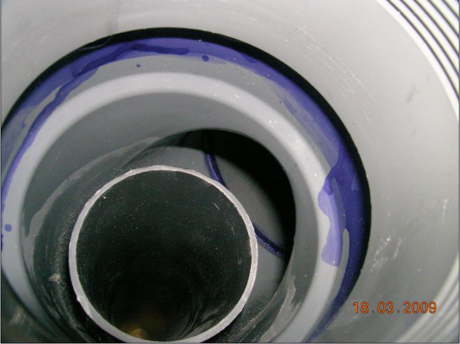

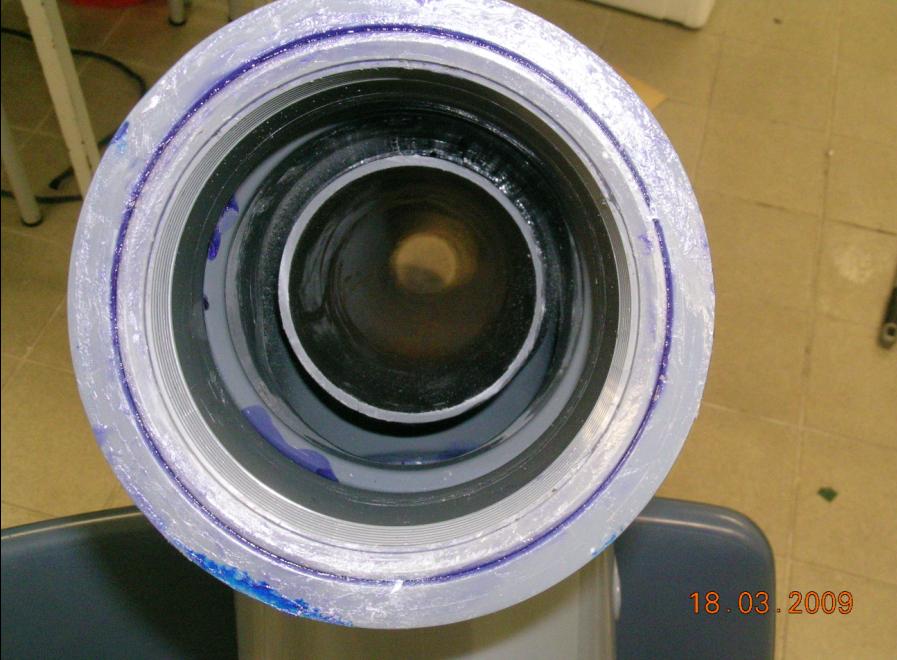

Update on piston:
Peel and stick sandpaper works fine. Not complete yet, but the same plastic bag now takes 5 pumps to drop off instead of 1 to fly off the last time.
As of now I'm not too familiar with using a compression spring (though I intend to get one at first opportunity). Just to check, it should be mounted on the end with the pilot & schrader to push the piston up to seal right?
What about using foam rubber as a seal? Would it be advisable at a pressure of around 160 psi (max pressure + safety margin of the cannon)?
Here are the pictures of the piston and the inside of the cannon in question:
Another view of the inside of the tee. Might be a bit disorienting at first glance though.

The inside of the tee. Note that the sanding is still not finished yet.
inonickname
Posts: 2606
Sat Mar 21, 2009 12:58 am
Ooh, a plexiglass piston.. make sure you make a good bumber and don't let it get too hot, or you'll know about it.

Sat Mar 21, 2009 1:51 pm
Pistons dont get hot from use unless there's some insane friction going on.
Those pistons look nice!
A spring isnt needed when you fill from the back. A bumper, however is VERY important. You could smash your nice plexiglas piston in one shot, or even worse, have it hammer through the back of the T.
Anything soft and squishy will do as bumper.
I'm looking forward to seeing it in use. :)
