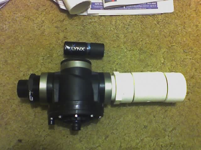

Quite a while back i got myself a 3" or 80mm hunter sprinkler valve rated to 220psi working pressure.
Scince then it has sat, but sit it shall no longer do, it shall rise the the occasion od un sittingness and furfil its destiny!!
*cough* anyway, here are some pics, first gun i am going to make with this beast is a small chambered small barrel compact gun for car storage and random shootings lol
Then when money allows i will build a biger chamber with poly so i can use it at 220!
Comments welcome.
UPDATE: Here is a pic of the proposed gun. The propane line is on QD to which a scrader valve can be hooked on instead, but mainly runing on propane from a 2kg.
I have glued the chamber and modded the valve. i tested the valve with a 1/2" BV pilot and it worked a dream! i found i cannon fill through the chamber unless it is sealed through pilot first if im using a bike pump. i have no barrel as of yet so no test shots were fred just dry shots.
It will be a 5 second gun as i call it, open propane bv, close propane bv, load GB fire and repeat.

- look at the screws!!
- 19-02-09_2305.jpg (30.25 KiB) Viewed 3232 times
- blue = propane setup
red = bv
pink = breach
grey = barrel
yellow = tee - 01-03-09_2341.jpg (39.4 KiB) Viewed 3012 times

Nice! 3" sprinklers are usually hundreds of dollars. What did you pay for this?
Only downside: Its a sprinkler.
Just like a 1" sprinkler has the flow of a 3/4" QEV, this 3" one will not have a full 3" porting.
It would be a very good main valve for a 2 or 2,5" barrel, but for 3" your real valve porting will surely be smaller then your barrel. Which is something that is OK to do, but personally I would never use a smaller valve then barrel.
220 psi is nice for such a diameter though, and the size makes it a great valve!

psycix - i got it for free!! the powers of the mystical rubbish tip!
i dont intend on using a barrel bigger than 2.5" anyway
jrrdw - thanks for the reply, yea i was just thinking that i mean who wants 3" porting
thats not a bad idea jrrdw, when i move out of surburbia i might just do that

What are you going as a pilot?
Not a long-hosed blowgun I hope..
It just screams for a QEV!

You know you could mod the QEV to fill from the chamber side. Just a suggestion.Carlman wrote:most likely a 1/2" bv as i want to chamber fill but we will see
- Carlman
- Staff Sergeant 2
- Posts: 1618
- Joined: Sat Nov 24, 2007 1:18 am
- Location: Western Australia
- Been thanked: 2 times
i could but i want this to be beastly but simple stupid at the same time, we shall see.daberno123 wrote:You know you could mod the QEV to fill from the chamber side. Just a suggestion.Carlman wrote:most likely a 1/2" bv as i want to chamber fill but we will see
