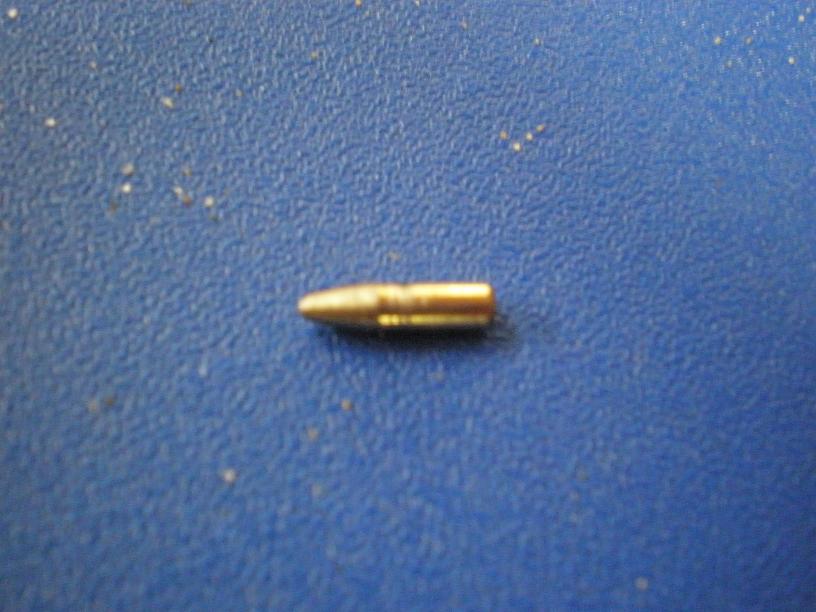

After my first successful copper gun, I decided I would give brass a try after I found a source of cheap brass tubing. This is yet another copy of JSR's pen gun with a couple differences; its soldered together, the piston is serviceable and I built a different way of actuating the schrader valve.
The gun is about a 1' 4" made from a 3mm tube and a larger tube I forgot the dimensions of, the piston is the back of a bic pen that I turned down to the right diameter on the drill press. I used a bushing soldered to the chamber to make to piston serviceable.
I decided because this gun holds pressure for a very long time, I wanted to have a trigger system that was attached to the schrader so I didnt have to find an airsoft bb or small rod every time I wanted to fire, so I built a little trigger mechanism that is friction fit onto the schrader and has a bicycle spoke that pushes in the schraders pin.
Only one damage pic for now, I should be getting a compressor that I can take this to over 300 psi with soon, but for now Im stuck at the one eighty my bike pump can do. I was test firing at some cans in my garage, missed and broke a glass sitting on my work bench. It also went through two full soda can lined up, hopefully tomorrow I'll have pics off this and a video. My ammo is small nails.
