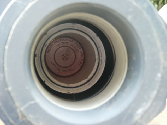

I'm up again. A few comments on the piston. If you have a piston that is difficult to seal, like this one, lapping in the valve is a solution. Make a long piston out of wood dowel that will fit in there and either use fine sandpaper or valve grinding compound and gently rotate the dowel in the valve area (snug fit) to wear the valve sealing face. With a little valve grinding compound on the valve seat then the piston face is mated to the valve seat in the same fashion.
Smaller valve seats are easier to do. Larger seats due to the size of the sealing area are much more critical to complete this step. In the attached photo, this process on the Dragon is shown. Note the sets of black marks on the radius of the valve seat. These are sharpie pen marks. The valve seat was lapped and sanded true to the valve cylinder by use of a piston with a sandpaper face. The seat was sanded until all the sharpie marks wore off evenly. When I started, several wore only a little. I marked often and checked progress until they all wore evenly. It is how I got the dragon to seal. Not the mark on the lower right is completely sanded off. It was my high spot. That is a 2.5 inch valve seat using a 3 inch piston. In the photo you can see one of the marks is worn down more than the rest. This was a high spot that not only provided problems sealing, but put a twist on the piston so it wanted to stick. This may be an issue you are having.

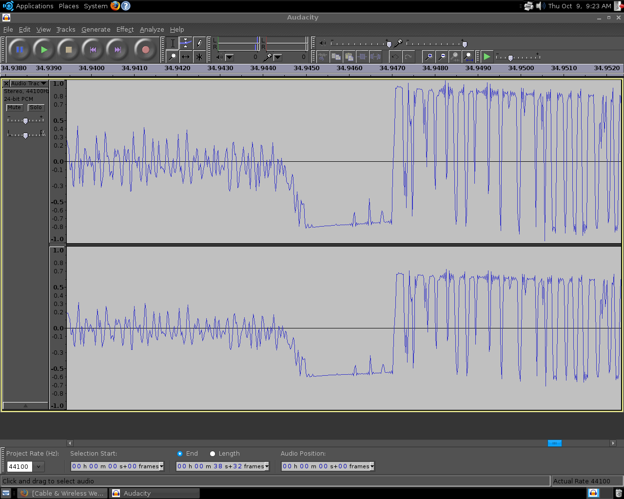

A proper opening valve has the air pressure surge right after the end of the hiss without any hesitation. The second waveform is my Mouse Musket discharge. Note the pressure wave is right after the end of the hiss showing the valve opened fully when it opened.
Am I the only one that can look at a waveform? Help the man out. The wave has been downloaded only 6 times, twice by me.

Perhaps I should try one of these MRR pistons?
I don't understand what the spring does.

There is no spring that I could see. The piston is made up of stacked washers and nuts on a bolt. Air filling from the pilot closed the valve.boyntonstu wrote:
Photo captured from:
BoyntonStu

Ooops! Wrong spectacles.Technician1002 wrote:There is no spring that I could see. The piston is made up of stacked washers and nuts on a bolt. Air filling from the pilot closed the valve.boyntonstu wrote:
BoyntonStu
You are correct, (as usual).
Why use stacked steel washers? What purpose do they serve?
Do they fit the chamber and therefore scrape the copper?
Wouldn't rubber washers be better?
BoyntonStu

I am working on a home built photo-transistor chronograph.
At the moment the signal is too weak.
Audacity and Technician tells us more about our cannons than any other tool.
So in a sense, I am glad that it didn't work.
Perhaps we should have a thread showing our Audacity sounds?

The hum is gone. The start of the hiss to the pow is about 0.06 seconds. Nice and fast. The waveform is clipped. The shot is very fast. I can hear the impact, but I too am having trouble seeing it in the waveform. It's fast. The target is hit quickly. I think that the small barrel and high pressure is creating a large high frequency component so the large long step I see with my cannons is not readily visible. Is there a way to turn down the mic a little during recording so the waveform doesn't peak so bad? It is LOUD. Nice sound. I like it.boyntonstu wrote:I tried a piece of thin (~3/16") open cell foam behind the rubber, bubbles.

It is a blast to shoot!Technician1002 wrote:The hum is gone. The start of the hiss to the pow is about 0.06 seconds. Nice and fast. The waveform is clipped. The shot is very fast. I can hear the impact, but I too am having trouble seeing it in the waveform. It's fast. The target is hit quickly. I think that the small barrel and high pressure is creating a large high frequency component so the large long step I see with my cannons is not readily visible. Is there a way to turn down the mic a little during recording so the waveform doesn't peak so bad? It is LOUD. Nice sound. I like it.boyntonstu wrote:I tried a piece of thin (~3/16") open cell foam behind the rubber, bubbles.

Can you guess where the sound of the hit shows on Audacity and estimate the speed based on traveling 20 ft with the mic in the center?
I am recording with the Audacity volume set at zero.
Perhaps if I place the mic inside an oven mitten, the sound will be more delineated?

Another shot with mic wrapped in a towel and inside a glove.
There should be at least 2 bangs after the muzzle blast.
The marble went right through the 5/8" plywood target and it dented a 3/8" sheet positioned about 7" behind it.
What a blast!
These were the parameters and I tend to believe the 800+ fps 120 fpe!
