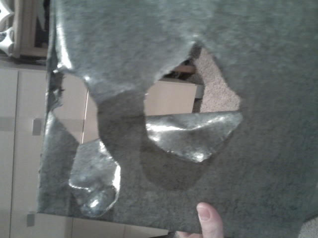

This is a damage pic of a piece of sheet metal.  This was done at only 15 psi.

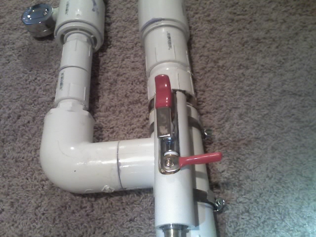

Closer view of the trigger assembly.

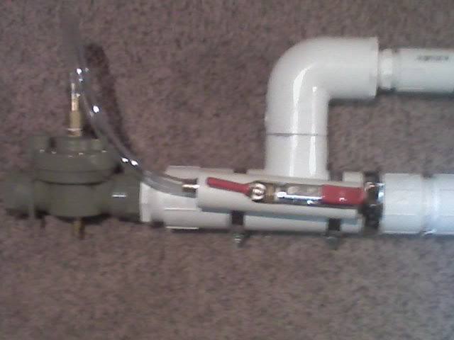

View of the back of the cannon.  You can see the trigger assembly here with the safety, and also the sprinkler valve.
