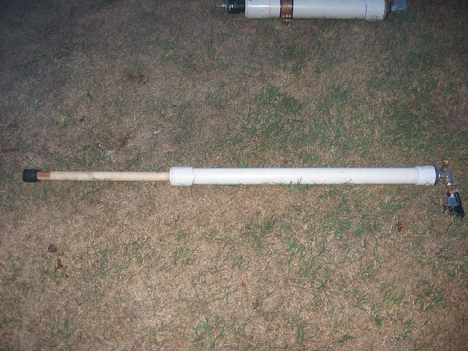

My very first pneumatic build. 2" chamber 1" barrel...  I've built and sold 6 others just like this one...

Your very first Pneumatic looks very much like my Mouse Musket, except the musket had the barrel end at the end of the chamber.
Mouse Musket.  2 inch chamber 1 inch barrel coaxial
