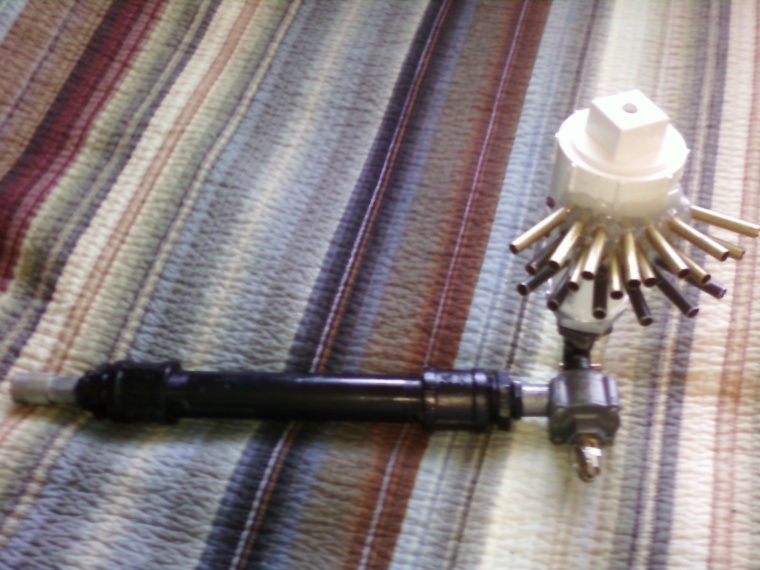

A few friends and I started to get back into airsoft, and since I haven't built many launchers lately I decided to tackle a claymore. It turned out much better than I expected, although it's not much to look at. I haven't painted the whole thing yet, but I plan on painting it all black. I forgot to take pictures of them, but I made a few stakes to hold it in place and keep it from falling over when it is triggered.
It uses fairly low pressure so that it doesn't hurt anyone. I have not chrono'd it yet, but I'm expecting it to shoot around 100-150 FPS.

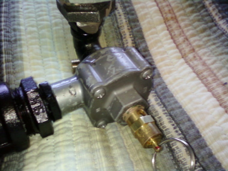

The valve is a 1/4" QEV.

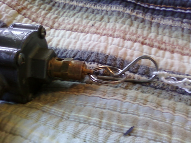

The QEV is piloted by a safety relief valve, which is pulled by a string. One end of the string is attached to the pop-off valve, and the other end can be tied to a stake in the ground so that it is held over a path where enemy team members are expected to walk.
The string is tied to a cotter pin so that when the string is pulled hard it will pilot the QEV, but at the same time it will disconnect from the pop-off so that it doesn't trip anyone or pull the claymore out of the ground.

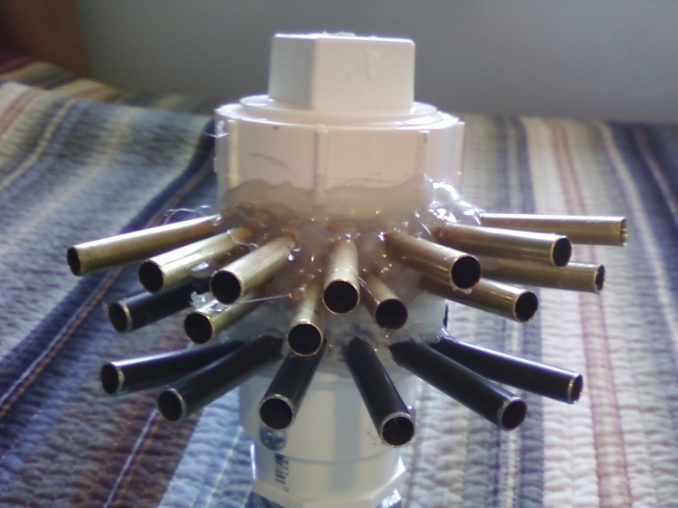

There are 19 barrels, all pointed in slightly different directions.
It works a lot better than I expected it to, but there are still a few changes that need to be made. As I mentioned earlier it needs paint. I will also replace the white string with fishing line so that it is harder to see.

haha excellent, looks like a pain to reload though
with a bit of paint it will be hard to spot in a woodland setting.

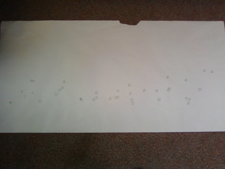

Did you try firing it at a few sheets of cardboard to see the spread?

I shot it a few times in my basement, and the spread was pretty decent. It is a 90* angle from the far left barrel to the far right barrel, so it should be more than enough. I'll have to find some cardboard and check it out though.

A safety shouldn't be that hard to implement. You could probably just slide a cotter pin into the popoff valve in between the spring.

Do you load one BB per barrel or do you fill it up? Filling each barrel completely will reduce the velocity, so by using higher pressure you can put a lot more plastic on target while keeping BB speeds at safe levels.

The pop-off valve is very easy to trigger, and it only gets easier at higher pressures. It is designed to open by itself at 125 PSI, so opening it at 100 is no problem at all. I have triggered it myself walking and running to make sure that the cord is not a hazard and to make sure that the velocity is fairly low, and before I could really even feel the trip wire the mine had gone off and the wire had disconnected.

I am currently using two or three bbs per barrel, and that seems to have a good balance of power and amount of bbs shot. If I start using more than three bbs in each barrel I will have to buy a new pop-off valve so that I can use slightly higher pressures.
I also tested the spread today. This piece of paper is about 5 feet wide. The mine was set up about 3 feet away from the paper. The shot was with two bbs per barrel @100 PSI.
