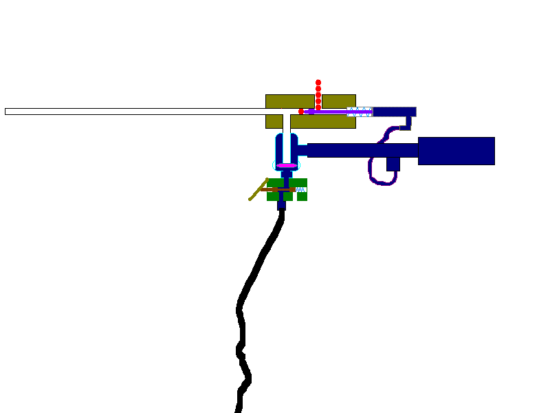

BTB's shattehand uses a modified QEV as the main valve and a hammer valve for piloting... the modified QEV will stay open as long as its pilot valve is open...
However, since the hammer valve opens for a brief moment and vents some air from the pilot side, the QEV also opens just for a brief moment...
as a result you get something that is essentially a single shot...
So it can be said that consistency of the gun depends entirely on consistency of the hammer valve (i.e. how much air it vents each time). If you used just a blowgun the QEV will stay open as long as you keep it open 9so you would waste a lot of air)
so if you want to use something else than a hammer valve with a modded QEV you need to find a way to vent exactly the same volume each time.. A small chamebr for vented air can do that
If you want semi auto just use the set up I have on the PITBULL 9 using a 1/4" QEV and 1/8" Normally open poppet Valve( Clippard MJV0-3) BUT use a different feeding method! as mine can only run at about 110 psi before it double feeds
Still my fave toy though, its insane to shoot, you can empty the mag as fast as you can push the button= damn I need to film it in action!
I did end up making the Chamber bigger and improved power a LOT

the 3way releases all the air that you need constant air, just like a nailgun
- POLAND_SPUD
- Posts: 5402
that's why I tried to make sure everyone understands that I was talking about a possible modification of BTB's design...
the PITBULL 9 uses a simple QEV + 3 way valve combo...
when the trigger is released the QEV is filled (hence normally open valve) but when you press the trigger the pilot volume of the QEV is vented to the atmosphere
the semiauto MKIII is exactly the same but it also has an air cylinder that loads ammo (while django's gun uses a simple T to do that)
have a look at the animation you said couldn't open -> http://www.wisc-online.com/objects/View ... ID=HYP4807
or look at the animation I created... I can't believe it took me only 20 minutes to make it

Patto wrote:Ok ok I'm sorry but I still think we've cross wire's here?
With all respect .. Don't worry about the hammer valve I know perfectly how they work , I want to know about the 3 way's and the vent chamber and how to use it
sorry man but can you shed a little more info please ???A small chamebr for vented air can do that
Does your (or yours Django ) 3 way work the same as a nail gun ? When you press the trigger does it release 1 amount of air and the when you release the trigger it exhaust !? OR does your 3 way just continue to release air Till you let go of the trigger??
How excactly does the vent chamber assist you ???

It only double feeds if I give it too much pressure( over 110 psi) under that it feeds wonderfully
Do I leave it plugged in= yes, I usually just use my 20 oz co2 bottle and paintball reg , I have a bulk co2 bottle out my back yard and refill the 20 ouncer when I want.
Distance wise ive only tried it out as far as about 20 meters and it constantly hits small energy drink cans with ease , so yeh for a home made job Im really pretty pleased but still room for improvement. Next inline I;ll be using a similar set up but bolt action so I can run much higher pressure but still planning on how to seal the bolt so no air leaks when shot.
