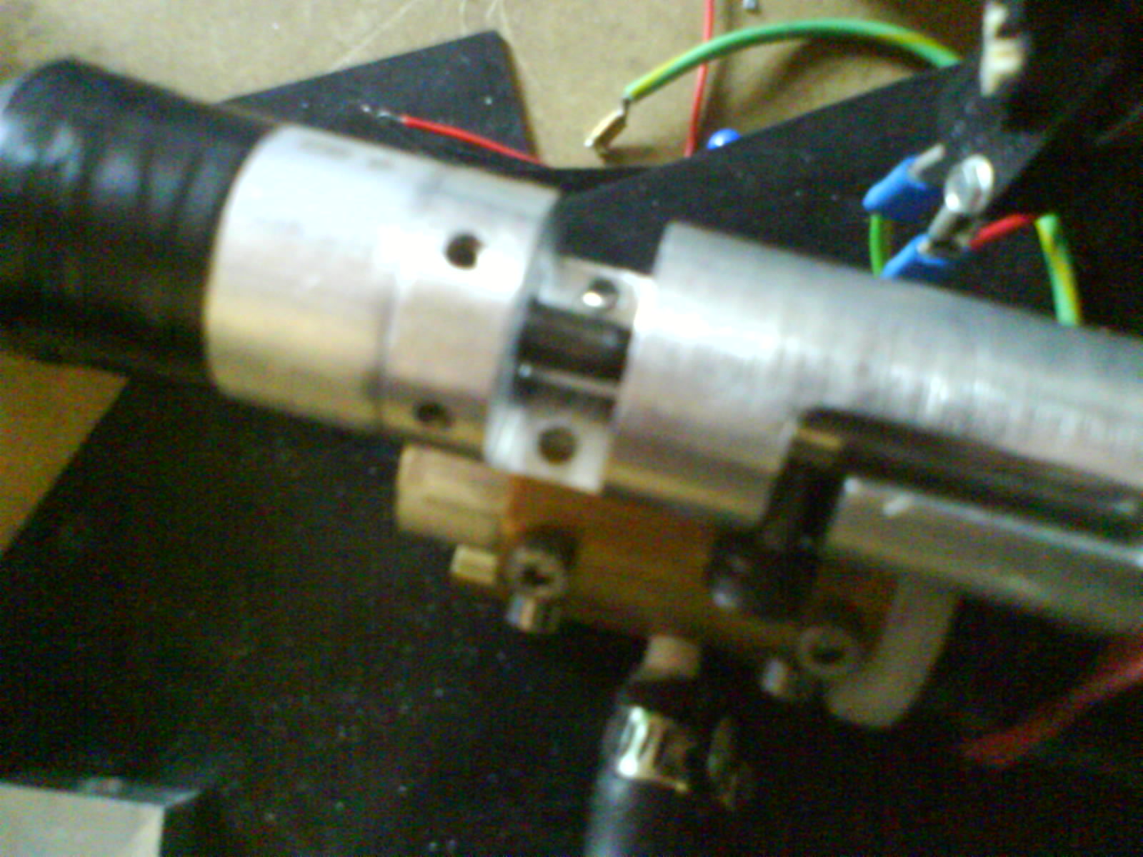

Hi, about a week ago I was thinking about making a bolt-action air rifle but due to laws I have decided to go with a bb gun.
Picture 511 shows the whole of my setup.
Picture 507 shows my valve and my bolt-action setup, I have inserted the magazine - my problem is that this simple magazine feeds about 3bb's into the barell - I need just one. Any suggestions of magazines that feed just one bb at a time - im trying to avoid using any more solenoids.
508 shows magazine removed - it is 10mm wide.
509 shows what pushes the bb's into the barell
510 shows the bolt-action locked
The magazine needs to have a 8mm hole for the bolt-action plunger to be able to clear it, any smaller and I may wear the seal out fast.
Any questions feel free to ask

Nice work joe and fantastic luck with getting your hands on those tools!
As to the magazine, have you though of fitting an o-ring to the port to keep BBs from spilling out on their own accord as soon as the bolt is retracted?

Finally the magazine
Im not quite sure how I would do that, could you give me some kind of diagram to what you are thinking.
The diagram attatched is basically my bolt-action setup. The port where the plunger goes is 6.8mm and the o-ring on the plunger is 7-7.5mm, edit this diagram to what you are suggesting.
The blue arrow is air
The magazine slot is 10mm
Thanks
Thanks
