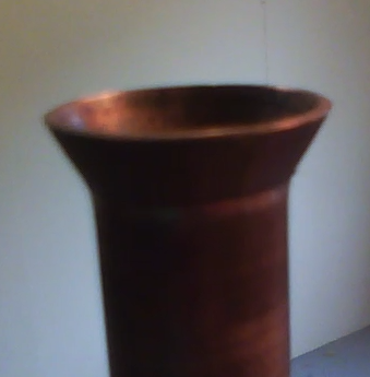

tghhs wrote:I also believe that this would create a more laminar flow for the air.
Depends. While it improves valve-to-barrel flow, it will inhibit chamber-to-valve flow.
While normally, V-2-B flow is the more limited, and thus worth trading C-2-V flow for, you will need to bear in mind that there is a point where taking it too far will start to undo the gains accrued.
