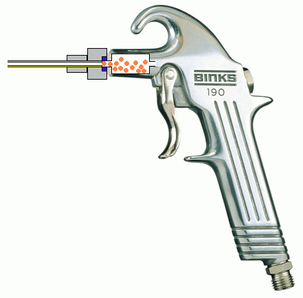

			By having the space between a detent breech and the valve port as a chamber, you could make a semi/auto pistol quite simply.  A light touch on the trigger will give you single shots, upping to full auto when fully depressed.  Probably not feasible using just the blowgun body as a chamber, but you could always hook it up to a larger tank.
- burstfireblowgunpistol.gif (38.35 KiB) Viewed 8563 times

			I'm sure you could fit about 5 airsoft BBs in the space between the valve and the barrel, and really for the tiny chamber that you have this would be enough.
