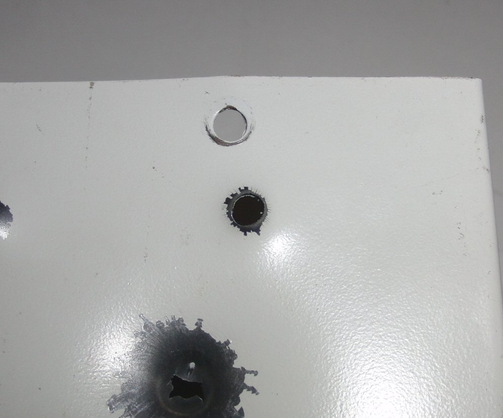

spurred on by the burst disk failure at 10x that left this thing intact, I went for 12x and HAHAAAA!!! 1487 fps with a 16 grain pellet!
Not 100% sure that's a reliable chrony result, but the loss of hearing seems to confirm it
Still won't make it through 2 sheets of steel though, but given the deformation of the lead on penetrating the first sheet it's hardly surprising. I tried with a 0.177" BB in a foil sabot at 12x and it punched straight through, you can see the entry hole top left in the first photo, and the exit hole in the second.
Yes, I really should make that suppressor before I go completely deaf
Edit: in order to put the chrony result into perspective, I did some test shots against the same targets with the same pellets fired from my fully charged FX Monsoon which was doing 850-900 fps, it only penetrated one sheet and the dent left in the second sheet was considerably smaller than those left by the mini hybrid at 12x, so I have no reason to doubt the result. That's over 75 ft/lbs, oh yes
