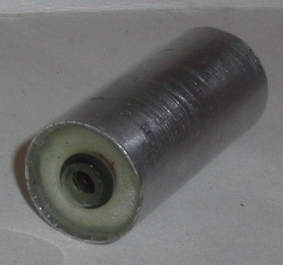

Tue Sep 21, 2010 4:24 am
Posted some development in the mini-hybrid thread but it belongs here really.
It would appear the "non burst disk" idea is feasible with o-rings, but now a question of etiquette, do I stick with the tiny 0.177" BBs - especially after finding out that power is a little on the low side even at 16x from a small cartridge - or do I go for something with bigger balls?
prototype cartridge with o-ring seal

Tue Sep 21, 2010 4:33 am
how thick are your epoxy plugs? and have you tested it yet? cant wait for a vid
edit; oh right didnt see the other thread
Has thanked: 581 times
Tue Sep 21, 2010 4:40 am
ilovefire wrote:how thick are your epoxy plugs?
About 1/4" in this case
No vid I'm afraid, as it can only hold a 4x mix the spark gap is far too small at it won't ignite at that mix. In any case, now that I've gone to 16x I'm not interested in something that low :roll:
