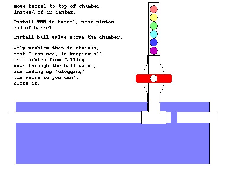

And since a picture is worth a thousand words, here is my answer:

The problem most people (at least those not conversant with modern binary adhesives :wink:) will find is sealing the chamber at the point where the magazine pokes out.
Why not leave out the ball valve altogether and have a marble machinegun ;)

The ball valve can be modified by placing a screw inside the ball at one end and removing the 90 degree stop so it can rotate a full 360. This can make a "cup" of the ball so it will pick up a ball from the top then drop it in with a 180 degree twist. Another 90 degrees will seal the barrel for firing.
Another twist on things is to put it external to the chamber as an over/under. I know, no longer coaxial.
My solution was to put the air valve at the muzzle end of the chamber instead of the breech and then use a traditional modified ball valve breech loader.

The problem most people (at least those not conversant with modern binary adhesives ) will find is sealing the chamber at the point where the magazine pokes out.
One could use a tee fitting I 'spose. If the chamber is 2" and barrel is 3/4", either use a 2" tee with the perpendicular port 3/4" or just a 2" tee with some bushings.

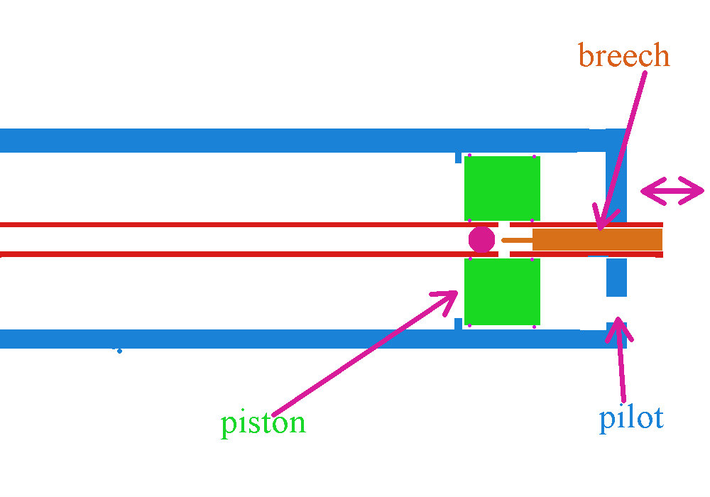

...or you can load ammo from behind though you'd need a special doughnut shaped piston

POLAND_SPUD wrote:...or you can load ammo from behind though you'd need a special doughnut shaped piston
Or throw in one of your favourite valves et voila, co-ax semi-auto ;)

Uhmm that would actually make a pretty cool gun. Since the whole gun is just a long tube (ohh btw you could add a silencer with the same OD as the chamber) you could easily make a nice stock for it (or just use one from a cheapo airgun)

POLAND_SPUD wrote:Uhmm that would actually make a pretty cool gun.
For a useful number of shots the chamber would have to be at pretty high pressure assuming you're only using the co-ax chamber as an air tank and not feeding through the pilot and dumping the chamber for every shot.
Well actually I've been thinking of an external tank...
though who said you can't add an on board pump?

Technician1002 wrote:The ball valve can be modified by placing a screw inside the ball at one end and removing the 90 degree stop so it can rotate a full 360. This can make a "cup" of the ball so it will pick up a ball from the top then drop it in with a 180 degree twist. Another 90 degrees will seal the barrel for firing.

The way I would approach the 'cup' idea, would be to find a tap of the appropriate size, and tap one end of the ball.
Then cut a ring, consisting of just a couple of threads width, from an appropriate fitting, and screw/glue that into the ball.
jackssmirkingrevenge wrote: The problem most people (at least those not conversant with modern binary adhesives Wink) will find is sealing the chamber at the point where the magazine pokes out.
It is difficult, but not impossible, to find a metal washer with an id that is the same as the od of a 3/4" pvc fitting.
Sandwich a metal washer, then a rubber washer, then the chamber wall, then a rubber washer, then a metal washer, on a close nipple, between the tee fitting inside the chamber, and the ball valve outside the chamber.
No glue required, (unless you want to go the extra mile and coat all this with marine goop, between layers.), and it can be disassembled for service.
This -would- require a rather large chamber, though.

I'm so glad this topic was brought up. I'm currently working on a coaxial piston pistol and I've been scouring by brain and the internet for ideas on how to breech load it. JSR is totally right, every idea I come up with a seem to run into problems making the mechanism airtight (but it shouldn't be a problem now). I am now considering using a pinball style mechanism to load the projectiles from an external magazine into the barrel. For larger scale cannons with relatively smaller barrels I'm also drawing stuff up on loading ammunition from the piston. PolandSpud's picture is fantastically helpful.

SP00K wrote:I'm so glad this topic was brought up. I'm currently working on a coaxial piston pistol and I've been scouring by brain and the internet for ideas on how to breech load it. JSR is totally right, every idea I come up with a seem to run into problems making the mechanism airtight (but it shouldn't be a problem now). I am now considering using a pinball style mechanism to load the projectiles from an external magazine into the barrel. For larger scale cannons with relatively smaller barrels I'm also drawing stuff up on loading ammunition from the piston. PolandSpud's picture is fantastically helpful.
I agree. I like Poland-Spud's idea the best.
