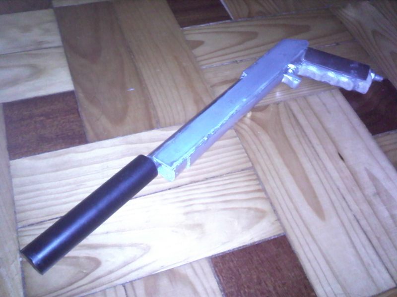

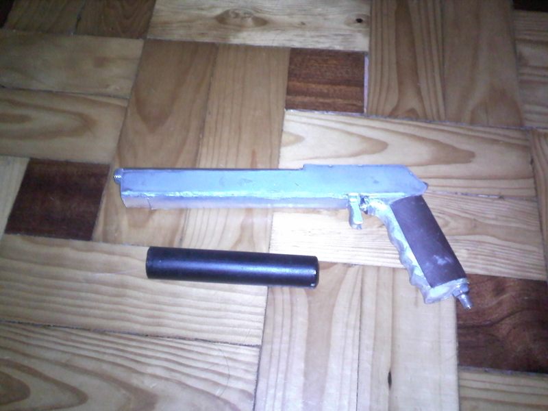

This is my new airsoft pistol, basically it´s my old one with a improved magazine and better look :)
The gun works VERY well, in power and accuracy it´s better than a decent airsoft pistol that you can buy :D
The silencer or the suppressor isn´t very well build, because I was without time to finish it properly :oops: , but it does make a noticeable difference :o
SPECIFICATIONS:
Magazine capacity: +- 5 bbs
About 4~6 shoots at 300 psi.
(The only BIG problem of this gun is that sometimes it shoots more than ONE bb a time :x And ruins the accuracy)
:D
:D
With the suppressor
With the suppressor
The gun without suppressor
The magazine
The magazine

Nice. Thats pretty cool. How well does the silencer work and whats the fps on it?

Yeah what is the FPS and what weight BBs are you using to measure the velocity...

The silencer works :) the first shoot at 300 psi it´s 300 fps, but than it gets slower, 0.25 g bb

Ah ok. So pretty much the psi = the fps for you? Nice. (try 1,000 and take it to a airsoft war... :P )

A video could be done. The fps does not = pressure when ultrapass 350 psi the bb will not fly a straight trajectory. Ya i always have a charged pistol in my room :D

very nice build.. Pity you haven't taken it to higher pressures. I love the simple design.. I feel like it could be improved though- have you thought about adding a larger chamber?
I don't think this sort of inline magazine is suitable for a "valveless" design, because instead of a burst of air that forces the BB in the breech down the barrel and the other BBs down the magazine, you're slowly building up the pressure so the natural tendency is for the BBs to want to follow eachother.
