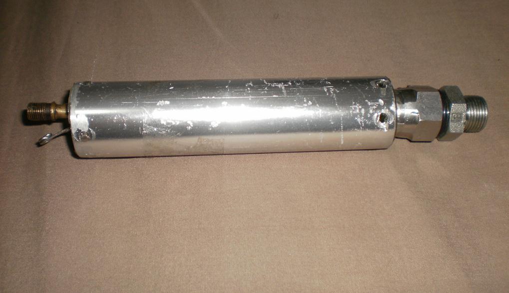

Second explosion in two days :D
The front connector decided to fail at a 9x mix. The bang was loud enough to make my ears ring under my ear muffs, but the reaction from my mom was more frightening :roll:
Luckily I have a stainless steel connector, wich should be able to survive the pressure. I used a burst disk with a 35 bar burst pressure.
You can see the connector in the picture above. I just need a way to connect the barrel.
