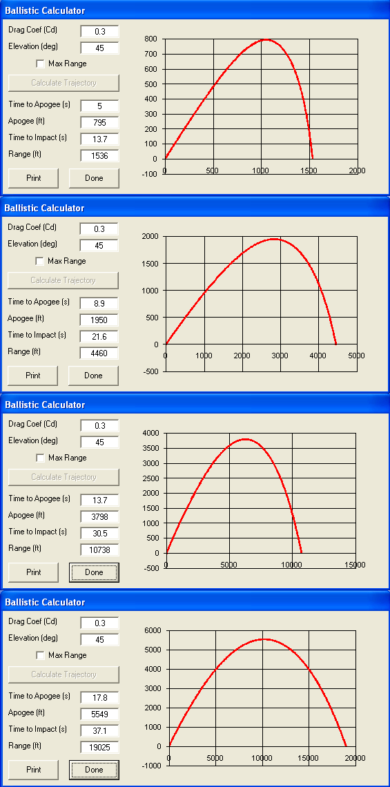

Attached some GGDT simulations using a 20 gram projectile in a 1 inch barrel fired at high subsonic velocity. In one series I varied the drag coefficient, in the other the projectile diameter (1 inch -> 0.5 inch -> 0.25 inch -> 0.125 inch), in all cases the velocity and weight was kept constant.

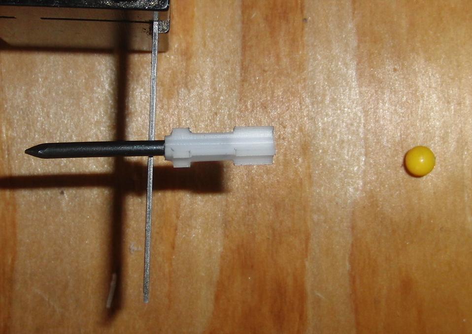

I might try a compromise using a delrin endcap with fins milled into it...
Also some more detail of the brass projectile.

Hence the modelling with reduced projectile diameter, which increases sectional density and therefore ballistic coefficient ;)

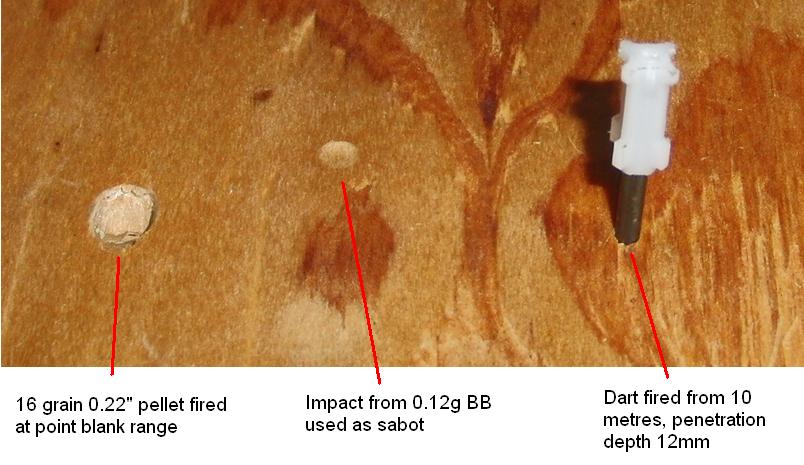

I had to trim the tail down because I went overboard with the milling but it made no effect on performance, flew superbly at 10 metres fired at 1/2" plywood. Compare the performance with a lead pellet from the same launcher at the same pressure fired at point blank range, the performance benefits of using saboted projectiles are plain to see.

Hit the ply nose first at 10 metres, bounced off.

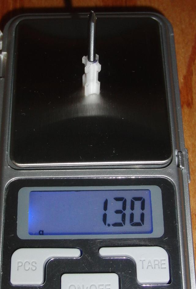

For what it's worth, CG was at the start of the delrin section and combined weight of projectile and wad was 9.05g.
