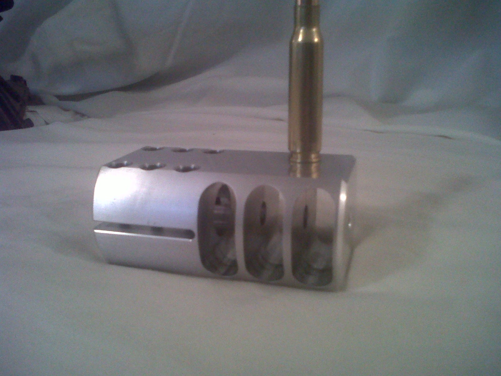

Here's some of my handi-work on muzzle brakes for firearms...

nice, looking very sexy :D
