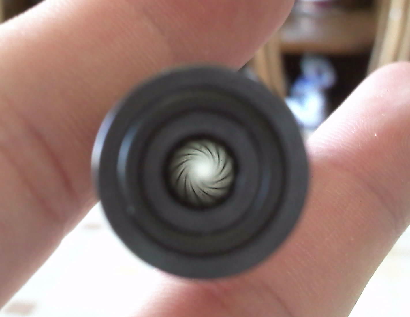

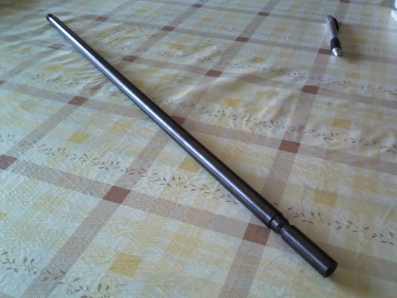

My weihrauch barrel arrived :D cost me 105euro total :roll:
Blued, chamfered, .177 cal 600mm.
The threading is on the muzze side, Gippeto you were right :) not a problem as I wasn´t planing on using it for barrel mount, handy for supressor mount through.

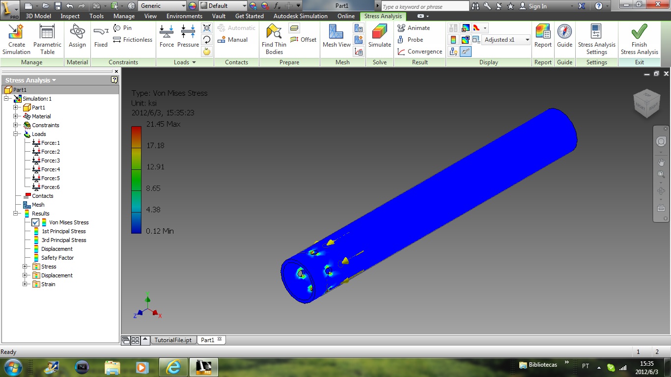

Yap that makes sense, I will do a FEA simulation :) by the way the unregulated part chamber maxim pressure will be 250 bar instead of 200, but I have checked the chamber yield strength, safe enough.
Edit, going to simulate the yield strength of 4 8-32 socket head screw in shear, also the bearing stress on the chamber wall.

Sun Jun 03, 2012 9:38 am
Made a simulation about 4 10-32 screw on chamber, safety factor about 1.5.
Increased to 6 10-32, minium safety factor 4.66 :) chamber wall 2.5mm thick. Now I only have to calculate/simulate to see how deep the screw should be :)
