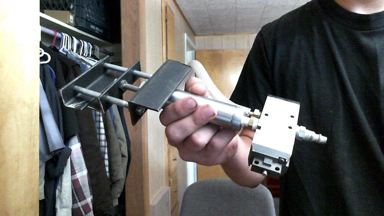

One question, how could I make this automatic?

Pneumatic Clipper
QEV + pop-off pilot?

Went ahead and made a qev+poppet valve setup. My poppet valve is 125psi and my compressor is 100psi, so I Macgyvered an external spring to lower its opening pressure. The bursts of air are to short to get a full extension of the cylinder.
Sound is crux, and the poppet valve exhausting is a problem. Going to stick with my orginal plan and have a exhaust line alongside the air in line. This way the exhausted air is discharged 50 feet away.
I'd like to make a mechanical switch that accomplishes the graph below. Seems simple enough but when I get down to thinking I can't figure out how to press the switch in one direction, but not the other direction.

uhmm you want to use just one switch??I'd like to make a mechanical switch that accomplishes the graph below. Seems simple enough but when I get down to thinking I can't figure out how to press the switch in one direction, but not the other direction
that can be done - though you might have to remove the spring return from the valve to turn it into a a toggle valve
- cs.JPG (16.47 KiB) Viewed 3695 times
