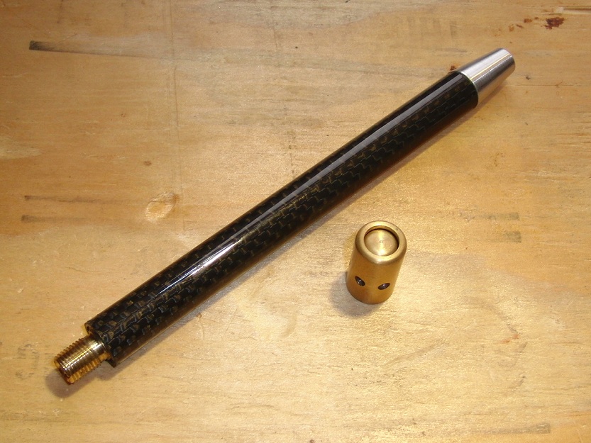

Just a little something I've been playing with, same old pengun design but using new materials.
I upped the calibre to 0.22", a bit overambitious and the 10mm internal diameter of the body tube does not allow for much air but still, it will happily push a 16 grain pellet through a beer can. Here it is in action at 300 psi:

Beautiful.
A 4.5 mm at 200 bar wound make this thing a serious killer

No, pure CF tube. This stuff.pneumaticcannons wrote:So is the body re-enforced or completely CF?
I don't know if I'd trust this one with that pressure, but there's definitely scope for a 200-300 bar pengun...A 4.5 mm at 200 bar would make this thing a serious killer

Just had a "why didn't I think of that" moment. I mean, those arms are perfect; robust, sexy, and practically made of epoxy.No, pure CF tube. This stuff.
made of epoxy
made of epoxy

Looks awsome!
I have owned commercial airguns ( pistol) with about the same performance...
With your machining abilities ....couldn't you get the most out of the concept by using hydraulic tubing?
Perhaps use an O-ringed sliding barrel as your valve, sealing against a rubber backplate...that would make it balanced so you could easily trigger it at high pressure...

holy crap, a legit pen, except machined out of high pressure steel, go up to 1000 psi, OMG this has soo much potential

... and loosely packed diamondspneumaticcannons wrote:practically made of epoxy.
made of epoxy
made of epoxy
... and this is at just 300 psi! Tried it at 400 and it leaked :-/
The little sherline doesn't really like steel, but there's no reason why a sufficiently thick walled brass or aluminium small bore tube couldn't safely take 300 bar.
I had some ideas for a "valveless" variation:
The problem is that at those pressures, it's going to be bloody hard to trigger. Past 300-400 psi the ballistic knife is almost impossible to operate. On the other hand, that's with a 13mm bore and 1.32 cm<sup>2</sup> surface area. With a 4.5mm projectile, the area drops to just 0.159 cm<sup>2</sup>... so extrapolating that, if 300 psi is fine for the knife, then a BB firing pengun is good for 2500 psi... the seal fitment is a bit tricky for a spherical projectile though.

now that you have a lathe you could experiment with metal on metal seals
while wouldn't be exactly very useful for pneumatics it has some potential for hybrids (especially for cartridge hybrids)

Note that the first diagram in my previous post doesn't have a separate seal but uses a lead projectile, I think this could be made to work for HPA.

are you assuming that pellet skirts can expand on their own to form a seal ? I don't think that's really what you meant.
Probably one would have to use swaging to make sure the projectile is sealed tightly
- Has thanked: 581 times
Some form of swaging is obviously needed, but the shape of the skirt should help.
Remember this?
It definitely works for lower pressures...
Remember this?
