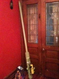

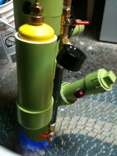

Chamber- 4" sch 4 PVC, 30"
Barrel- 2" PVC, 60"
80mm chamber fan run off 12v battery held inside the body.
Ignition- Dual spark, run off an electric BBQ lighter.
Propellant: Metered MAPP gas
HGDT gives me an approximate FSP of 600 using MAPP gas. However, the little Devil on my shoulder told me (after using NO2 "safely") that an additional input of metered Oxygen was a good idea..... IT IS NOT.
Yes, Oxygen/MAPP is fun to shoot. No, it isn't meant for non-metal cannons
YouTube video of the cannon shooting with Oxygen/MAPP:
This was before the last picture. Anyhow, I'd like to make an aluminum combustion cannon using MAPP/Oxygen. I know I'll be advised to "just make a hybrid", but since I am relatively new to all this, I'll take smaller steps, please.
That being said, any advice on how to build an Oxygen/MAPP combustion cannon that can be used later on as the foundation of a hybrid?
Sorry for the poor picture quality. Hmm, who could the last picture be for?
*The cannon was rebuilt after failure.
