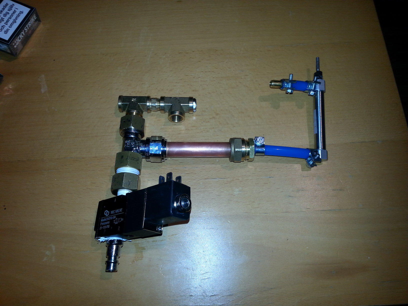

Testing out the cylinder with a tire valve as rebound spring!
It works but i don´t like the setup! rely hard to get the right pressure!
And 8 bar wouldn't extend it to maximum position whit out to get it close again!
Hmm need to order 2pcs 3way valves or one 5way double solenoid:P
BTW made some own nippels with m4 bolts! Will use fuel hose next time:P easier to make seal prof and softer!
Some pic´s
Test rig.
Test rig.
Close up.
Close up.
Gnarp
Posts: 31
Joined: Thu Aug 22, 2013 4:02 am
Wed Aug 28, 2013 2:29 pm
oops forgot to make the arduino video! to late now! to much noise:P
