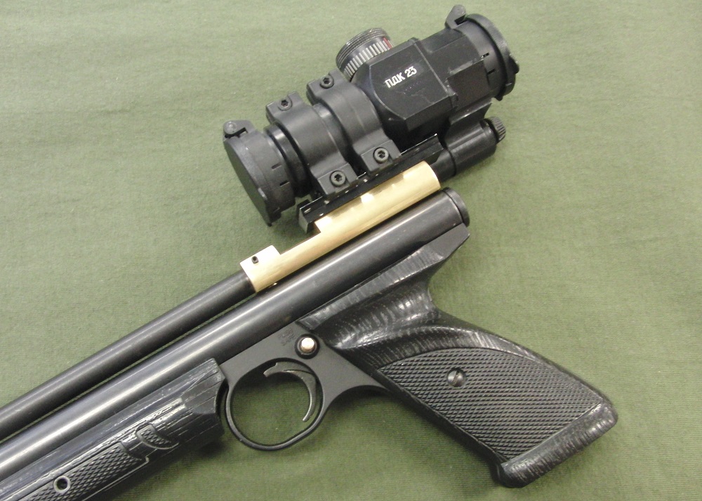

Some more progress in the meantime, I slid a bit further down the slippery slope and made a brass safety button to replace the stock plastic item, and added a grub screw to the breech to stop the barrel from rotating.
A 5 shot string at 20 pumps had a velocity coefficient of variation of less than 0.01 which makes it remarkably consistent.
Herewith some final photos:
Last edited by jackssmirkingrevenge on Mon Dec 24, 2018 1:39 pm, edited 1 time in total.

Very nice.
Since you already slipped down the slope a bit, it sure would look nice with a walnut fore-end and grips :)
