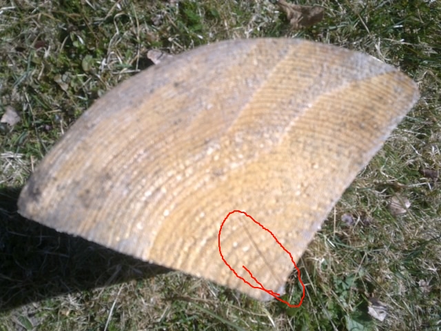

Yeah, I'm gonna do it without the fan *first* because I've got three parts of the wood anyway, and I'm not going to make three statues anyway, maybe two, and thanks for the meticulous tip goes for Fnord. Btw, do you need a pic of the wood piece? I haven't measured the piece, but the height is about 25 cm at least, Here's some pics on how the piece fits in the barrel and of a small crack in the wood:

Yeah, seal the ends of it up and it should stop the crack from spreading.
Worst case scenario, if it does, just split it open and glue it back together.
You'll need to have some way for the moist air to get out of the barrel. A couple 1" holes will probably work.
