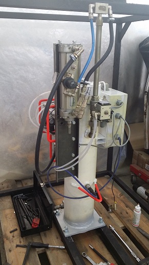

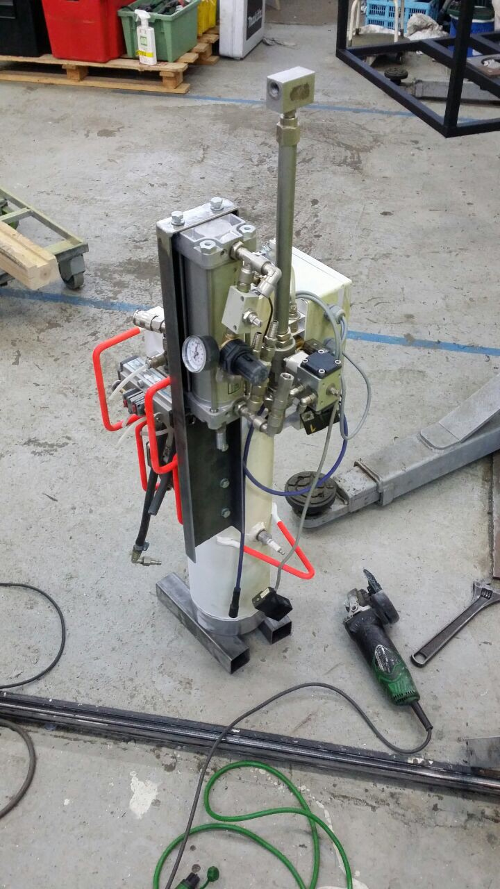

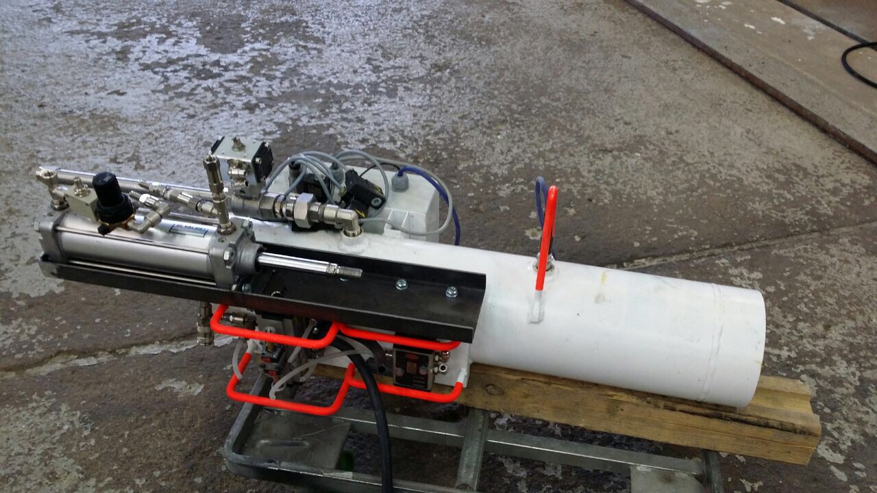

And the real setup.. (sorry for the bad picture)
Real thing.. 90mm porting piston valved hybrid. Diameter of chamber is 160mm.
There you can see the pneumatic cylinder that is used as a propane meter and pump.
