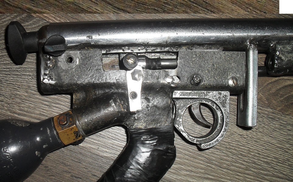

Fixed a few things..completely redid the bolt assembly and the sear.
The sear is now set in a sled.After pulling the trigger the sled is pulled back by springforce.As the hammer catches it on the way back the sear is blocked by the rear of the trigger ...wich enables semi shots. Releasing the trigger causes the trigger to slip under the sear so it can be triggered again.
But the sled can also be prevented from sliding back disabling the auto-locking of the sear.
This makes it fire in full auto.
As it became quite annoying to take the gun apart and then put it back together numerous times as I was tinkering with the triggermech I decided to change the way it was held together.
Now only one bolt locks the receiver to the main tube.
Fieldstripping can be done without tools and under one minute.
The lever can be set to semi- or full auto, or block the bolthandle in the rear position.
This makes it easy to insert the mag as the bolt is fully retracted and it disables the whole trigger mech,making it function as the safety.
hope you enjoy!

- cowscankill
- Private 4
- Posts: 73
- Joined: Sun Apr 10, 2011 8:09 am
I love the raw metal look, with all the welds and stuff. Great build!

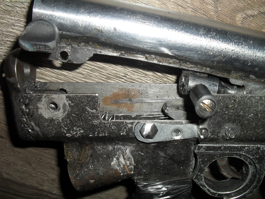

Here's a side by side of the select fire lever.
Look closely, you'll see it blocks the axle of the sear.
Locking the sled in place so the sear cant slide off the trigger makes it full-auto.
Looks worn and homemade..
