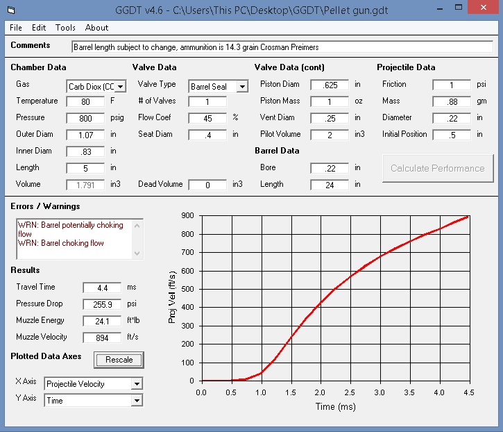

Sorry for taking so long to respond, I've had a while to play with GGDT and some ideas.
I was going to make my own QEV to handle higher pressures, along with this I plan to operate it off of a 20 oz CO2 cylinder (I've got at least three lying around along with an ASA fill adapter, to adapt the threads over to 1/8'' NPT). As I've said I've went about comparing the two valve models on GGDT and it seems that a QEV rifle will rival a hammer valve pretty well. So far my current configuration yields results of almost 900 fps (I want to get a high velocity for power but still stay under the sound barrier so that the pellets won't destabilize after being fired).
Some GGDT specs
Some GGDT specs
Extending the chamber to 6" knocks the velocity past that 900 fps mark :lol: , which rivals the closest PCP rifle (Benjamin Discovery). Although I'm unsure of how long my CO2 tank will last (I realize there's probably a pretty simple way of figuring this out, but I haven't done this yet).
I'd like to try and stick with a QEV, correct me if I'm wrong but I feel they'd give more consistent power/shots since the chamber is being filled to a consistent pressure. I was also wondering, how consistent are paintball tank regulators for air? And could I use one for regulating the CO2? I was going to use a pop off valve for the trigger (pilot valve), but being a pop off valve the gun would fire if over pressurized.

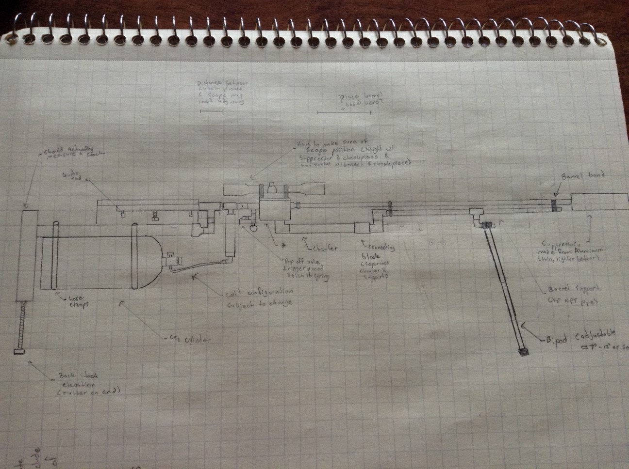

One final concern is the breech access, so far I only have the idea of a piece of the barrel cut out near the base for the pellet to be loaded into, and then two o-ring grooves to be cut into either side of the slot and a piece of tube that slides over the breech and seals with the o-rings. I don't know how efficient this will be, any thoughts?
If it helps, I could upload some of my drawings to show where I'm at right now as far as design goes. Thanks for all the feedback :)

Reality check time.
If you get 900 fps on co2, you'll be the first to do so. Some have claimed 800fps, but their claims remain unsubstantiated as far as I know. Have done mid 700's so figure the 800 claims are at least possible.
Pellets do not destabilize by shooting them through the sound barrier. They destabilize when they pass BACK through the sound barrier....keep them fast all the way to target and they WILL group. Have seen it on a Condor shooting .177 @ 1400fps.
Paintball regs are pretty good. Not sure how they would handle co2, but construction is basically the same as the Palmer Female stabilizer (paintball co2 reg)...might work. Would likely have to lower the set point though to ensure you're metering gas and not liquid.
The Condor (and other Air Force air rifles) use a sliding breech cover, as do some of the Korean big bore air rifles (Fire 201). Sometimes "absolute" efficiency takes a back seat to practicality...don't lose any sleep over it.
Drawings and diagrams are always helpful to convey an idea...if you have them, post them. Can't hurt and might help.

I don't know how much it will help but here's a cruddy drawing.
The chamber, barrel support, and parts of the stock and handle are made from iron plumbing fittings, the QEV will be machined from a steel block to handle the pressure.

Yep...'tis I. :lol:
Using air will allow you to make more power. No reason you cannot use co2 if you want to, just lower your expectations a little.
Have you considered using a slide check in place of the relief valve trigger? Will shut the flow off from the supply while venting the qev at the same time. Just a thought. :)
If you've not purchased your coil line etc yet, can get one with a slide check so you don't have to buy it separately.
