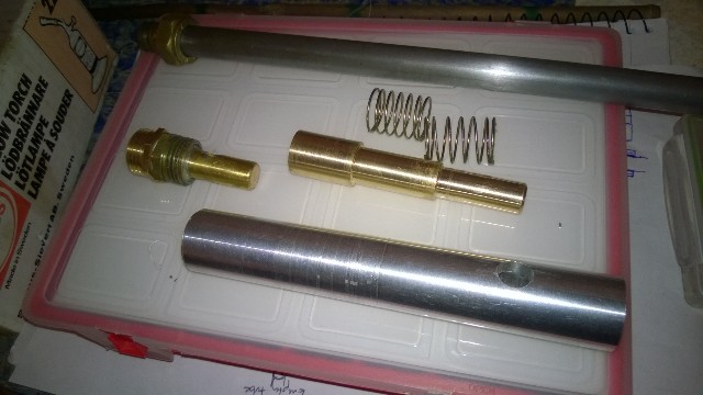

I have turned and drilled an aluminum housing for my blow forward bolt design, I tried acetal bolts, 1st one accidentally got 850psi up its behind ( lack of thinking) this caused an earsplitting bang and a 2 piece bolt! I made a second and am having trouble with it sticking forward as I am using alot softer spring (sorry no way of measuring the spring but first one you could probably half its length squeezing hard as I could between thumb and 1st finger) so I got some 1mm wire springs which are easily squashed by hand.
I am to use in the range of 300-500psi what kind of spring rates are normally used, I realise alot depends on piston area but I need to find a balance of returning piston quickly but also at the same time absorb the impact as the piston is halted from its forward motion.
I am now making a brass piston as I feel this will hold up better and also allow a smoother action.
Sorry if its all abit vague but asking for any advise anyone has, I am listening...
Details - breach/cylinder main bore of 19mm (allows taping for 1/2" bsp threads for air/barrel fittings.
Piston just under 19mm diameter with 13mm hole in base to sit over air supply tube.
Ammo 9.5mm steel ball bearings.

Photo of breach/bolt and then when assembled (to follow as need resizing for forum)

Had a problem with the bolt jamming forward, after a bit of thought it was found the bolt was going a bit too far past the air entry tube and not reseating, so I reprofiled the inside of the back corner to give a better angle, tested and it was fine, tried with some ammo and I am pleased with power. Just need development of the magazine and then some form of stock/bodywork.

Interesting, is this for a semi or a full auto? You can reduce the pressure on the bolt by having a smaller area for the air to act on, can you show us a diagram of what the internals look like?

Sorry don't have a diagram it is basically what is shown in photo, hopefully the blow forward force will be reduced now I have about a millimetre until it angles inwards to help reseating on the supply tube, it is also a less than ideal fit in the aluminum tube as it was the only piece of brass I had, I will use a magnet to secure the ball bearing or a (can't remember name) basically a bolt with spring and ball bearing in it to hold in place until it gets the main blast of air.

I have one solenoid that is working ok at 350psi, if not I have another Chinese copy of the Burkert 5404 which is rated at 25 or 30bar, my aim is to build an automatic gun, I would like high power but that is not my ultimate goal. I had considered bleeding a bit of air bit now have the spring working. I found this solenoid, its low flow is what concerns me, I will try what I have and see how they go if necessary I will lower my pressure goal.
Solar - sorry you lost me in the last paragraph, I am just a newbie, not sure what system it is realy the bolt just blows fowward until the barrel ( I aim to machine barrel/bolt so the bolt actually penetrates the barrel to help sealing). Do you have any threads on your gun build? I am just learning from here and youtube.

Thanks for the pointers and tips, much appreciated. This project will probably need remaking as it has been a learning experience in using a lathe which I haven't done before, hopefully this one will at least work, therefore encouraging me to improve it. Main problem at the moment is due to the rather loose fit of my brass bolt in the aluminum tube, as it returns it sometimes jams on the air feed tube, I have hopefully overcome this now as it seems it was more to do with the threading in the end of the tube causing it to pull out of alignment when tightened.
Wed Mar 18, 2015 11:39 am
Ianbuckwell wrote: Main problem at the moment is due to the rather loose fit of my brass bolt in the aluminum tube, as it returns it sometimes jams on the air feed tube, I have hopefully overcome this now as it seems it was more to do with the threading in the end of the tube causing it to pull out of alignment when tightened.
If you have enough thread lenght you can face the mating surface and that should stop the tightening from causing the misalignment.

Caan I just check I have understood you correctly as there is plenty of thread and if not I can lengthen them, you are saying rather than using the O ring to compensate I can slightly angle the end of the aluminum outer tube to match the angle of the brass fitting that is the air inlet to the cylinder, which would then stop one side from touch first which is currently causing the inlet supply to go out of parralel with the aluminum tube?
Thanks for the suggestion, I hadn't thought about it actually fixing the problem, I had only considered quick fix ways to get around it, but this would be much better as it would allow the joint to be tightened up properly.
Thu Mar 19, 2015 6:01 am
Everything I said is assuming that the threaded hole is centered and straight on the X axis, correct? If not the bolt will always be mis-aligned. If the threaded hole is true and correct and the 2 flat mating surfaces (where the o-ring is placed) are true and correct the end result will be a true and correct assembly.
Quick test: Assemble the parts outside of the breech lay them of a flat surface (workbench / table with the hex head hanging off the edge) and roll the assembly. If the end of the bolt wobbles 1 of 2 things are wrong or both. 1. The hole is not drilled straight and or 2, the bolt is not true turned to center.
Excessive clearance between the bolt and breech can also cause jamming.

Thankyou for replying, I will check the alignment, I know the air entry tube is pretty straight as when put in the lathe holding on the brass fitting it did not really move, piston/bolt is kind of loose in outer aluminum housing but not drastically, although the bolt is true as this was machined, I have a feeling that the threads I put in the aluminum are probably the major cause as these were done by hand rather than on a lathe so are probably not aligned properly.
I think it is going to be a case of using this as a learning experience and if I can get it to work satisfactoraly I will remake the parts, but this time paying closer attention to tolerances.
Thanks for the help, this is my first 'spud gun' to have parts made by myself and my first time using a lathe to attempt to make something accurately and I got caught out as I thought the bolt was jamming due to the bases diameter so turned it down a bit, but then to find that it was not the cause so it ended up smaller than I needed it! I also need to measure more and also believe my calipers.
