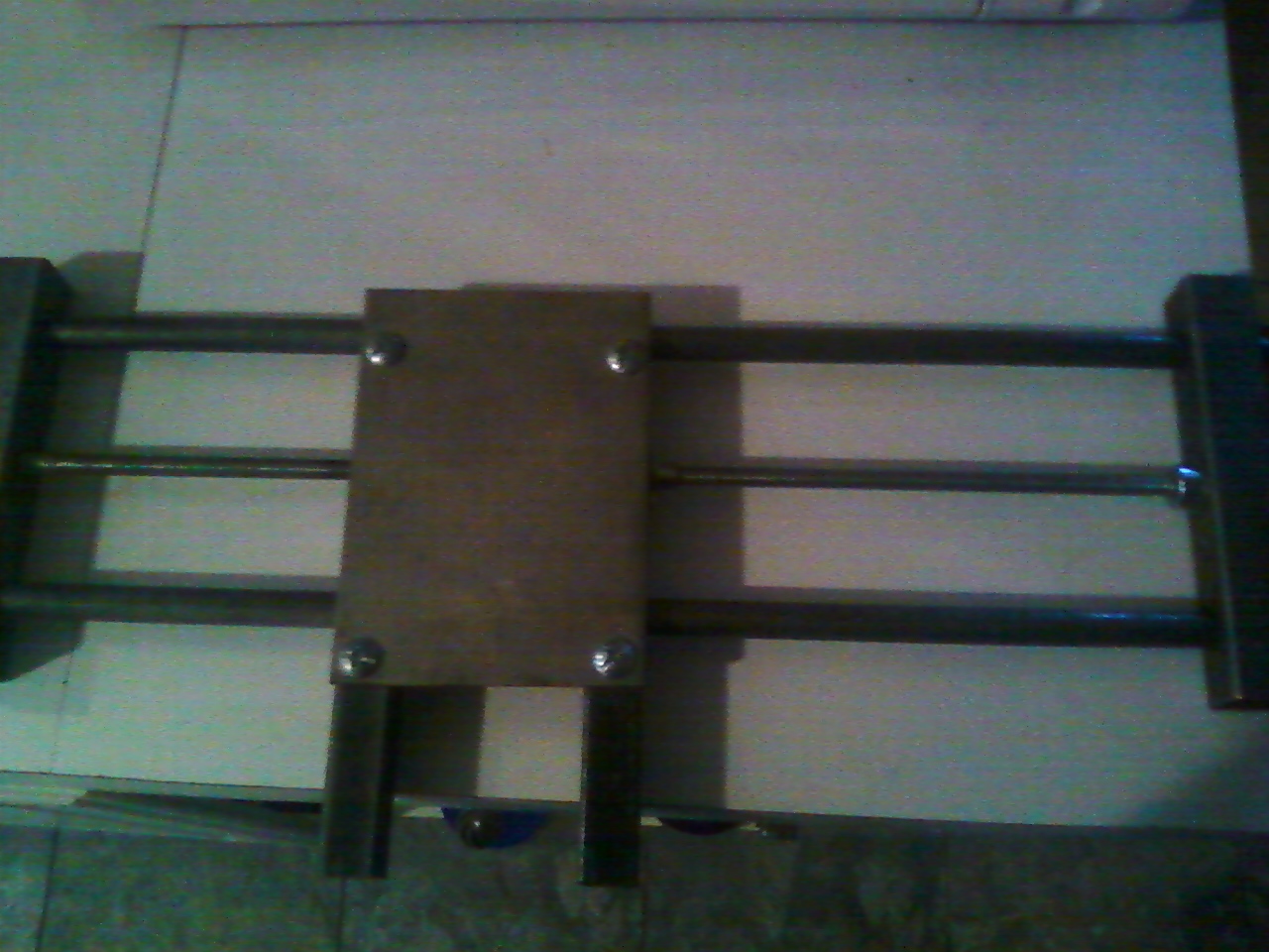

I went down to the hardware store and got a piece of 3/4 inch steel square tube to make the tool carriage from.
The carriage is 8 inches long and 4 inches wide. Unfortunately, due to some wobble in my drill press (and difficulty getting accurate measurements) the holes in the carriage slides weren't aligned with the "table" rods. A little work with a file fixed that. (if the lathe works, I'll be rebuilding it with tougher parts anyway, so perfection isn't the goal here)
I couldn't find a piece of steel at the hardware store wide enough and thick enough to work as the top of the carriage. Since it has to bind the two 3/4 inch square tube pieces together AND hold the tool, it needed to be at least 1/8 thick, if not more. Luckily, I found a piece of stainless steel from a boat conversion kit I had and cut it to fit.
It wasn't quite long enough to cover the whole thing, but it gets the job done. I'll add another section to complete the tool carriage top. To tell the truth, I actually bolted the steel to the wrong end of the tube steel, but after thinking about it for a while, I decided to leave it. I think it'll make the carriage a little more stable in this position. (again, if the lathe works, I'll buy a piece of steel big enough to cover the whole carriage)
The tape is there for scale, for those of you of the measurementally curious. Next, I'll be drilling the holes for the lead screw for the tool carriage and tail stock. The lead screws on this will be standard all-thread. It's not perfect, but it'll do for now. If this were a more precise lathe, I'd be worried about backlash in the all-thread.
I'll pick up the all-thread and nuts for the tool carriage when I go get the glass I'm casting the concrete slab on. I was discussing with my mom how to get a perfectly smooth surface on the concrete slab (she used to work for company that tested the stuff) and she suggested pouring it in a form with bottom made from a piece of sheet glass. We'll see how that goes.

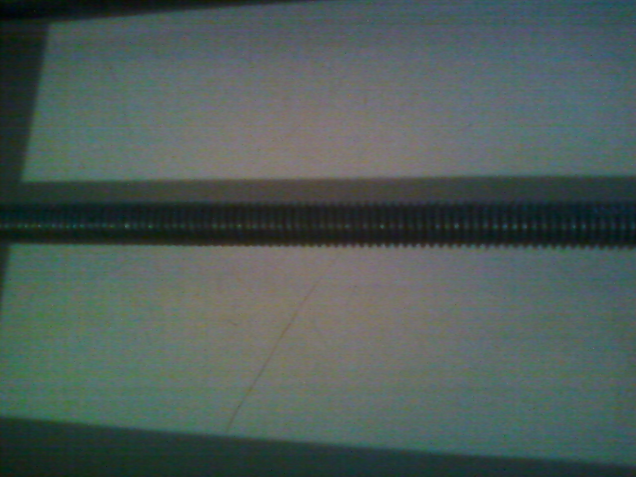

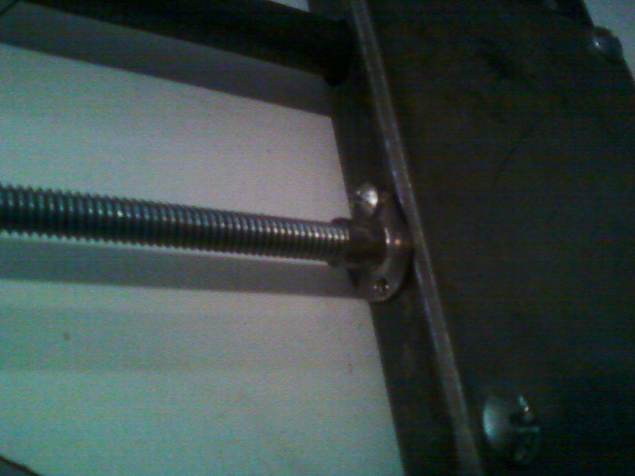

I had a meeting at work today, so I dropped by the hardware store at the way home and grabbed some parts to make the lead-screw for the tool carriage.
The lead-screw is 5/16 inch all-thread.
The shaft-collars hold the lead-screw in place fairly tightly with minimal slip when I reverse directions. I can cut down on what slip there is by clamping the shaft-collars against the tube steel before tightening them.
I think this is called a flange nut (not sure, but that's what I'm calling it) and it was ridiculously expensive. $1.84 for the little thing (almost as much as 3 feet of all-thread!) but it saved a lot of trouble. It's screwed to the tool carriage.
Here's the assembled tool carriage lead-screw. Since it's just hardware store grade all-thread and fittings, it's got a fair bit of backlash, but it's not to bad, all things considered. The thread pitch on the all-thread is low enough that it takes a lot of turning to get the carriage to move an inch, but that's okay. If I need faster carriage movement later on, I'll gear an electric motor to it. I had the electric drill on it earlier and boy, did the carriage fly! I think I clocked it in at two or three feet per minute at one point. :D
