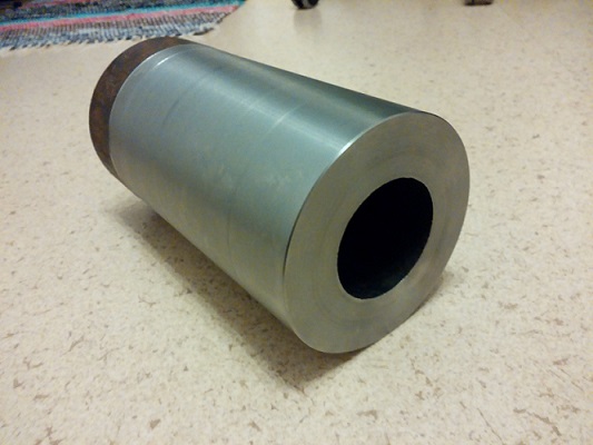

Today I started machining a chamber for a hybrid that I have wanted to build for a long time. I recently started studying to be a machinist so I now have access to large lathes and mills to do my projects on. Here is a picture of the partially machined chamber: It is 143mm OD, 75mm ID and about 270mm long at the moment. The OD is in its final dimension but the inside surface has not yet been machined, so it will probably be 77 or 78mm, depending on how much the hole is off center, I havent measured that yet but it is in the 0.5-1mm range. It will have a chamber volume of about 1250-1300cc depending on the final chamber ID.
I have done some pressure simulations on it in AutoCad Inventor, it suggests that I could do 75x shots with butane with over 2.5 safety factor. This simulation is with 700 bar continuous pressure:
The steel the chamber is made of has 355MPa minimum yield pressure, so the max of 170MPa stress suggested by the simulation is nowhere near its breaking point. According to HGDT simulation at 75x my max chamber pressure will be 530 bar so the stresses will be even lower than in the simulation picture above.

Awesome little project you got here, and nice to see more Finns catching up he hybrid bug! What kind of projectiles are you planning on launching out of it?

There's something about you Nordic types and insane hybrids looking forward to see this fire! What will the barrel diameter be and what are you doing for ignition?
I dont know about the projectiles yet, I could machine some darts or maybe make a lead casting mold for some balls or supersized airgun type pellets. The barrel diameter will be around 30mm, I have not yet searched for a good barrel pipe from my local hardware store. The gun will be pretty heavy when finished, the chamber piece alone weights over 25kg so the finished cannon will be probably close to 50kg if not more. The weight will help with the recoil so I dont think its a bad thing, I wasnt going to make a handheld cannon either way.
The ignition source will be a thin piece of wire with a small capacitor bank to turn it into plasma to ignite the mix, similar to larda's design. I dont have complete plans for the cannon yet as the design depends on what size and material pieces I can find to be machined.

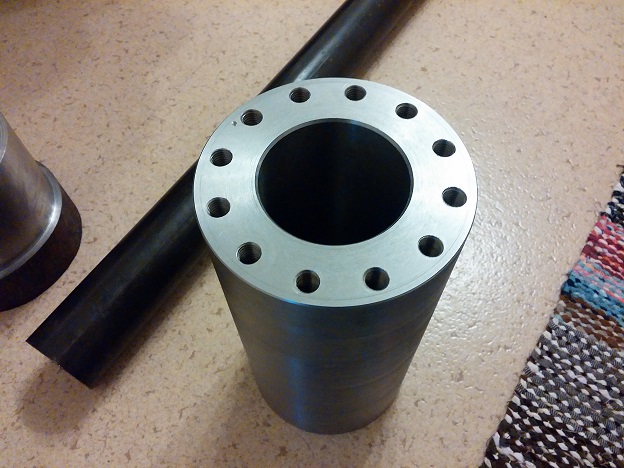

I've build similar type chamber and connected the endcaps by many M12 screws. You can make threaded bolt hole circle in the chamber pipe ends if the wall thickness is sufficient. It's more compact and cleaner look then tie rod type.

Seconded, your wall thickness is insane.matti wrote:You can make threaded bolt hole circle in the chamber pipe ends if the wall thickness is sufficient.

I know I could and the wall thickness would allow it, but it would require me to make the chamber volume smaller to keep the same theoretical burst pressure for the chamber. HGDT simulations suggest that at 75x mix the reduced chamber volume would decrease the kinetic energy by about 10% and at low mixes like 10x the kinetic energy decrease would be about 20%. The bolt holes in the chamber walls weaken that part of the chamber, so to keep the wall strength I would have to do it like this:matti wrote:You can make threaded bolt hole circle in the chamber pipe ends if the wall thickness is sufficient. It's more compact and cleaner look then tie rod type.
If the pressure area would go all the way to the end of the chamber, there would be lots of local stresses in the walls of the bolt holes even larger than those in the inside walls of the chamber. That would make the bolt holes the weakest part of the chamber if not made like the diagram above. For M16 bolts class 8.8 the minimum thread engagement length would be around 25mm so I would have to drill atleast 30mm deep holes in the chamber. That would make the decreased chamber length about 40mm on each end and thus making my effective chamber length about 190mm long compared to the original 270mm. To me the cleaner look is not worth the decreased power. If however I am unable to find a large enough piece of round steel then I would be forced to do it this way.

I got some machining done today, the chamber piece has now fully machined surfaces and tomorrow I will drill and tap some holes to the ends for attaching the end pieces. The chamber ID ended up at 77.6mm. There is not much more to see at the parts at the moment, I will probably take a picture of the chamber tomorrow if I get the bolt circles all drilled and tapped.
EDIT: Bolt circle is now done on one end, it has 12 M12 bolt holes.
