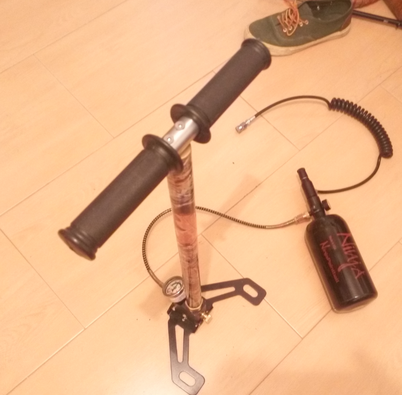

So the paintball tank, adjustable regulator, adapter & pump arrived. I also got another QEV & Slide vavle.
I removed 2 shims from the regulator to get about 550 PSI of output pressure.
It took me about 20 minutes (with 1 minute brakes every 5 minutes) to pump the 48/3000 tank to 3000 PSI.

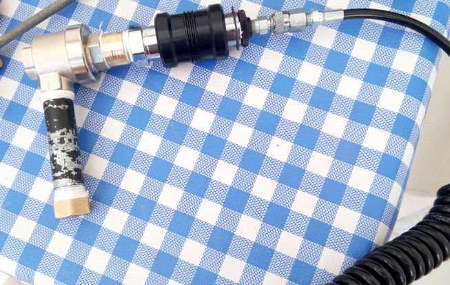

so, i just started testing today & i got a problem. I've connected the paintball tank with the remote line to the slide valve+ qev, like this:
it's the exact same setup as the first rifle only instead of the soda stream tank i got the paintball tank with the regulator.
when i open the regulator and take a shot, the slide valve won't go all the way backward (creating a leak), i think the pressure is to great for the slide valve to move all the way backwards. when i close the regulator & stop the air, it's easy to move the slide valve.
I've noticed on vng21092 .177 QEV+Slide Valve post that his paintball tank is connected to the air port, not to the pilot port & the slide valve operates fine at 800 PSI. is that the solution?

Sun Apr 02, 2017 4:19 pm
Increasing the pressure should make the slide valve harder to open (more force on the o-rings -> greater expansion -> more friction) but it shouldn't limit its range of motion.
The beauty of the slide valve is that it is a three-way valve, simultaneously piloting the valve while also closing off flow from the main chamber. Note that in the example you posted, there is a separate ball valve that you need to open to fill the chamber before every shot, and then close before firing to avoid emptying the whole tank.

Tue Apr 04, 2017 1:33 pm
I removed on more shim from the regulator & now the slide valve is moving smoothly. got a different problem now (it seems like a never ending project, but i like it): the PCP pump stopped working, i guess i was pumping it to fast and one of the O-rings went bad.. I'll rebuild it this weekend (came with a rebuild kit) .
