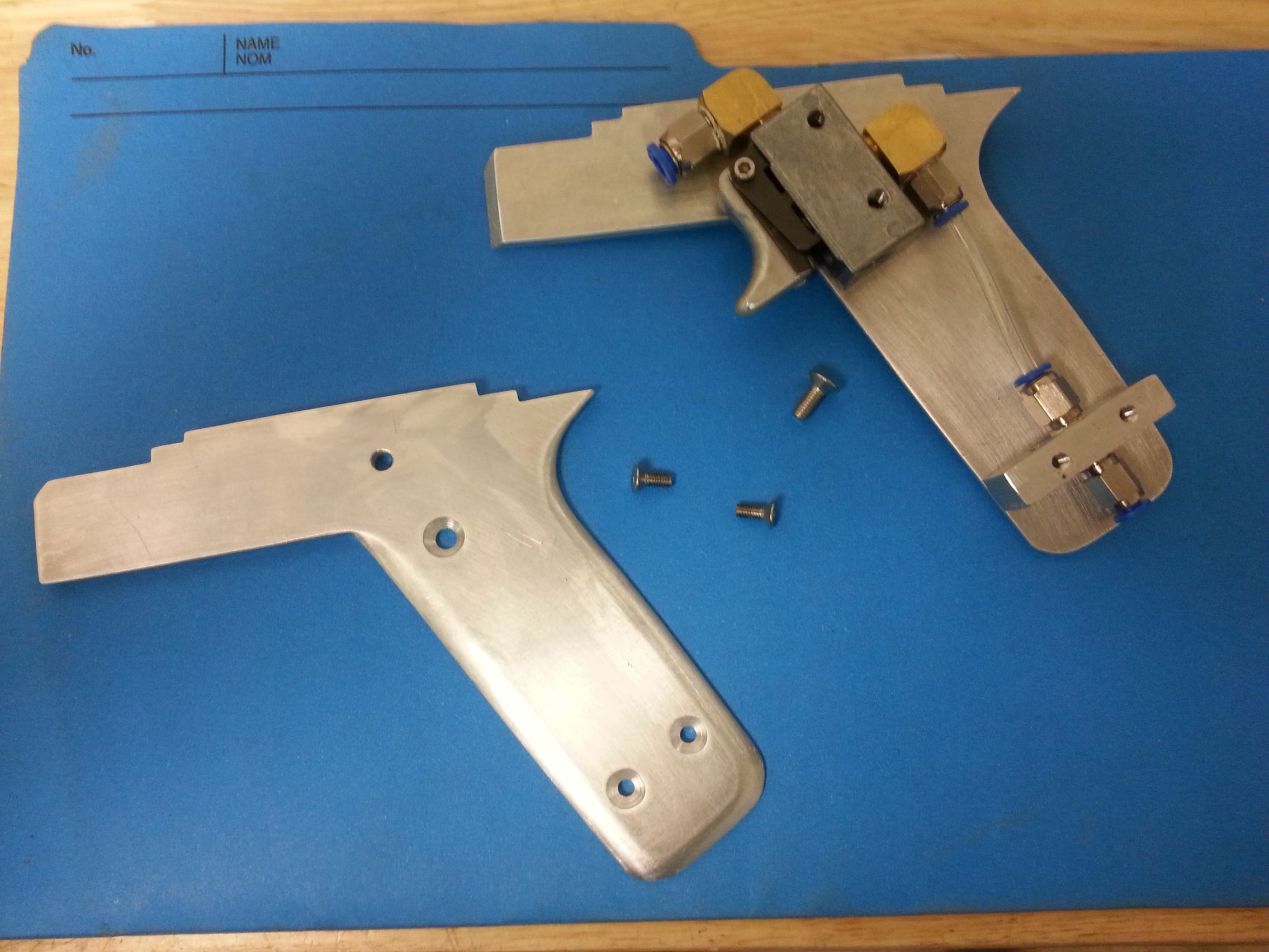

So I got it finished quite quickly today, 2 barrel sleeves and spacers made and painted. Turned out looking better than I ever thought it could. Barrel extension is removable with 2 bolts, stock with 1 bolt.
Fully assembled weight is 3.25Kg (7.2Lbs) length is 1015mm (40") Barrel is 6mm ID/10mm OD seamless stainless, total length 600mm (from breach) 23.5".
short barrel is 280mm (11") the extension is 320mm (12.5")
The lower body is the chamber, 1" PVC. The main valve is a 3/8" QEV off Ebay, trigger is a 1/8" 3/2 limit switch.
All the aluminum parts are made from scrap pieces I collected, all hand fabricated, probably 40 to 60 hours to put it together , I never keep track really cause I make parts as I go along for more than one project at a time :shock:

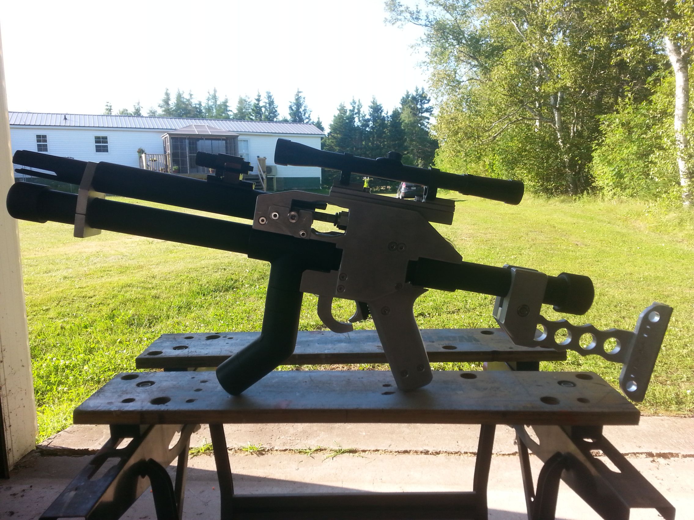

Just gonna make a couple of extra parts for it, trigger guard and a barrel cover when the extension is not on, like a birdcage flash hider
Did a rough chrono check with the Android app, 0.2g BBs = 300fps with long barrel, 280fps with short. :o
Will try and get some heavier BBs, maybe 0.4s, especially as my next project has a much longer barrel.

The finishing touches, flash hider under construction
The finished project in short barrel

Nice work on the flash hider, looks very clean overall. I like how the stock is built off of the chamber. Looking forward to the video.
