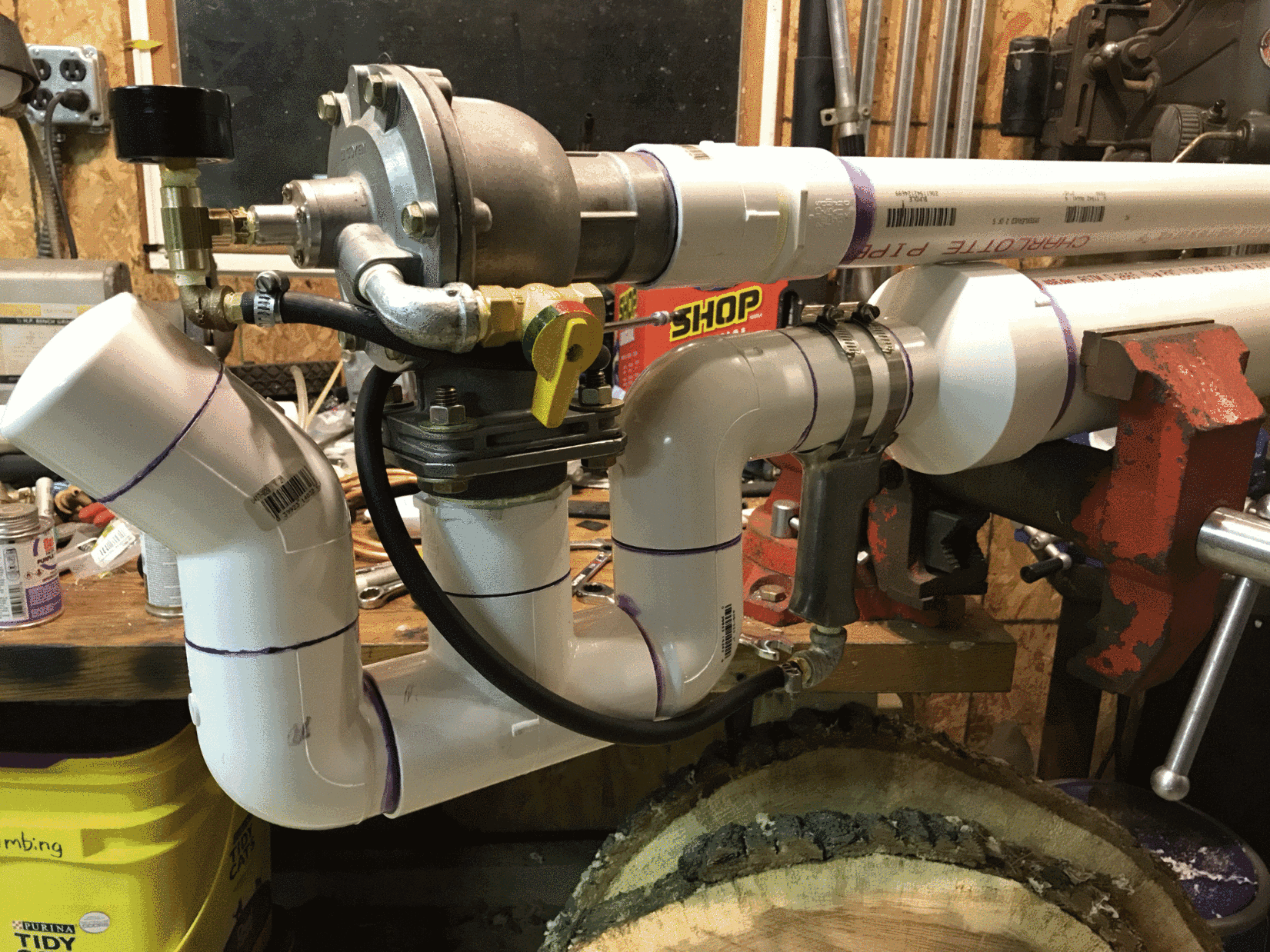

So here it is. The almost straight from the legal pad golfball cannon MK III. There was a MK I before all of this that... well let’s just pretend that never happened.

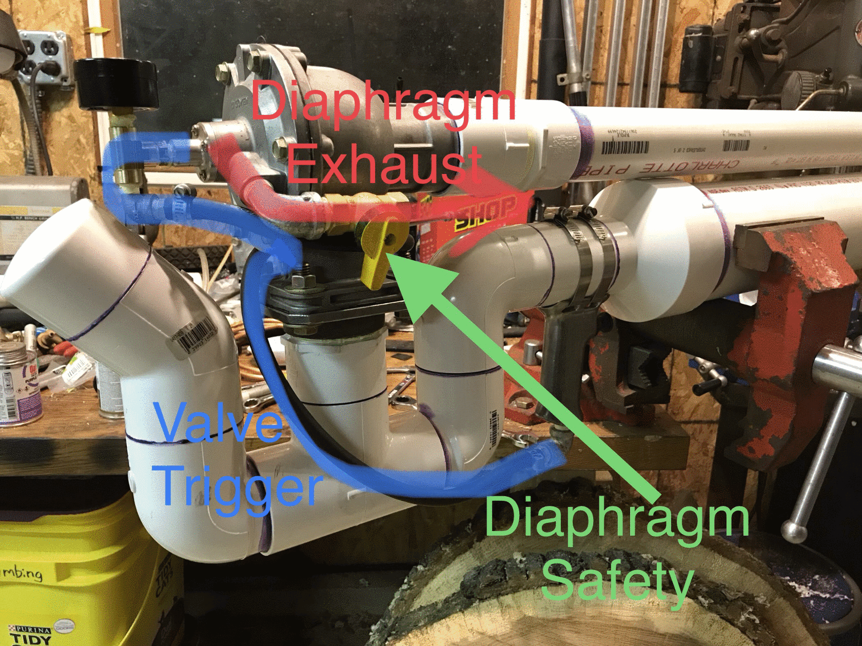

I realized that the exhaust port on the QEV could use a ball valve as a safety of sorts. When the trigger releases the pressure off of the back of the QEV, the diaphragm tries to exhaust out the side. With the “safety” ball valve closed, nothing happens except for a quick puff (and small hiss) out of the trigger... NO shot fired. Tested and works at all pressures, just a little peace of mind. I also machined the air hammer handle into a nicer trigger setup. I use the term machined loosely as all I have to use at the moment is a drill press and an X-Y slide vice. The air flow through the handle is still impressive, even though the flow/volume required to actuate the valve is minuscule. Final addition was a pressure gauge on the back of the QEV. I relocated the fill plug for the resovoir to the front of the chamber but I don’t really like how that looks. I’d like to put it somewhere else, but I’m not sure where it would work out (suggestions?).
I realize the barrel is not attached to the chamber yet, I forgot to pick up the pipe clamps when I was at the store.
I have 3 working barrels, same as before; 2” small tennis ball (small dog balls :lol:), 1-½” golfball (with Backspin “break”), and a ½” nerf dart barrel. The nerf dart barrel also shoots foam ear plugs quite well.
About the only place it's going to be safe if you keep it on the chamber "as is", is on an end cap, so either where it is (at the business end of the barrel, even with safety...) or at the other end of the chamber.
My understanding, perhaps wrong, was that it's easier to charge through the pilot valve.

mrfoo wrote:My understanding, perhaps wrong, was that it's easier to charge through the pilot valve.
I’m not sure if I am able to charge through my pilot valve since it is a two diaphragm valve. I do know that I cannot charge through the “exhaust” port, but my interest now is to see if the pilot valve is usable as a fill point. That would be fantastic :bounce: I really don’t like the way the fill looks up front.

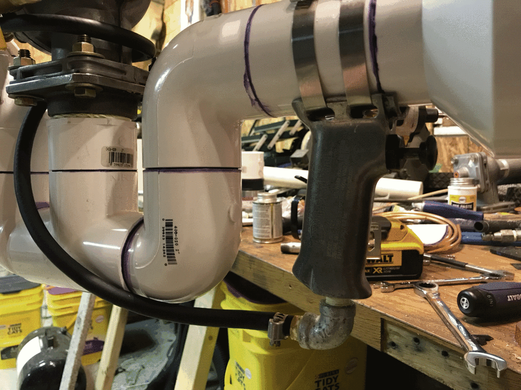

jackssmirkingrevenge wrote:Nothing better than a visual demonstration, it will serve as a good manner of illustrating the importance of barrel support of future builders.
Without straps
Closeup without straps
WITH straps
Closeup With straps
