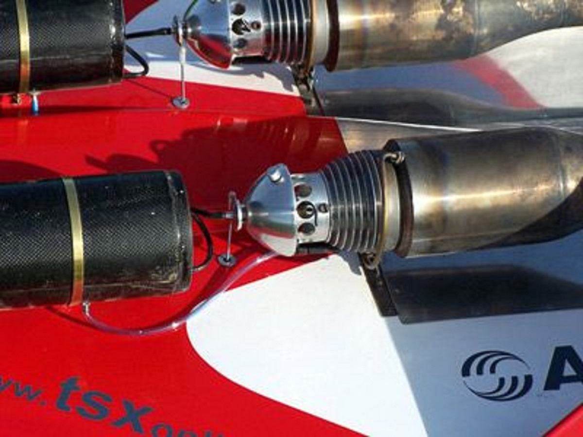

What we use for the pulsorreactores, not to impoverish the mixture of combustible air, when it is in flight, especially in chopped, is a "static air bell". It is a simple element that deflects the air inside the diffuser of the carburetor, and this carburetor works with static air, In the photo is together with the engine stop mechanism. Independently of the speed of flight they are normally about 250 300 km / h. In certain models it is not necessary but in our case, the engine stopped abruptly in this type of maneuvers.

Ok I'm looking for some info and I'll add it here. But the "idea" is very basic. You just have to avoid the direct entry of air with a stopper that should let air in only on the sides. You can test with the air of a compressor. You must determine approximately the speed of your model, and simulate that speed with compressed air, and see if you stop having that problem. I imagine it will be solved.

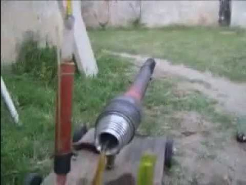

I went testing tonight, and my sound cannon is very sensitive to air blown into either the output or input. I have a few ideas to check out to fix this, but now I need to concentrate on fixing my exhaust and hope for good weather for more in-flight testing.

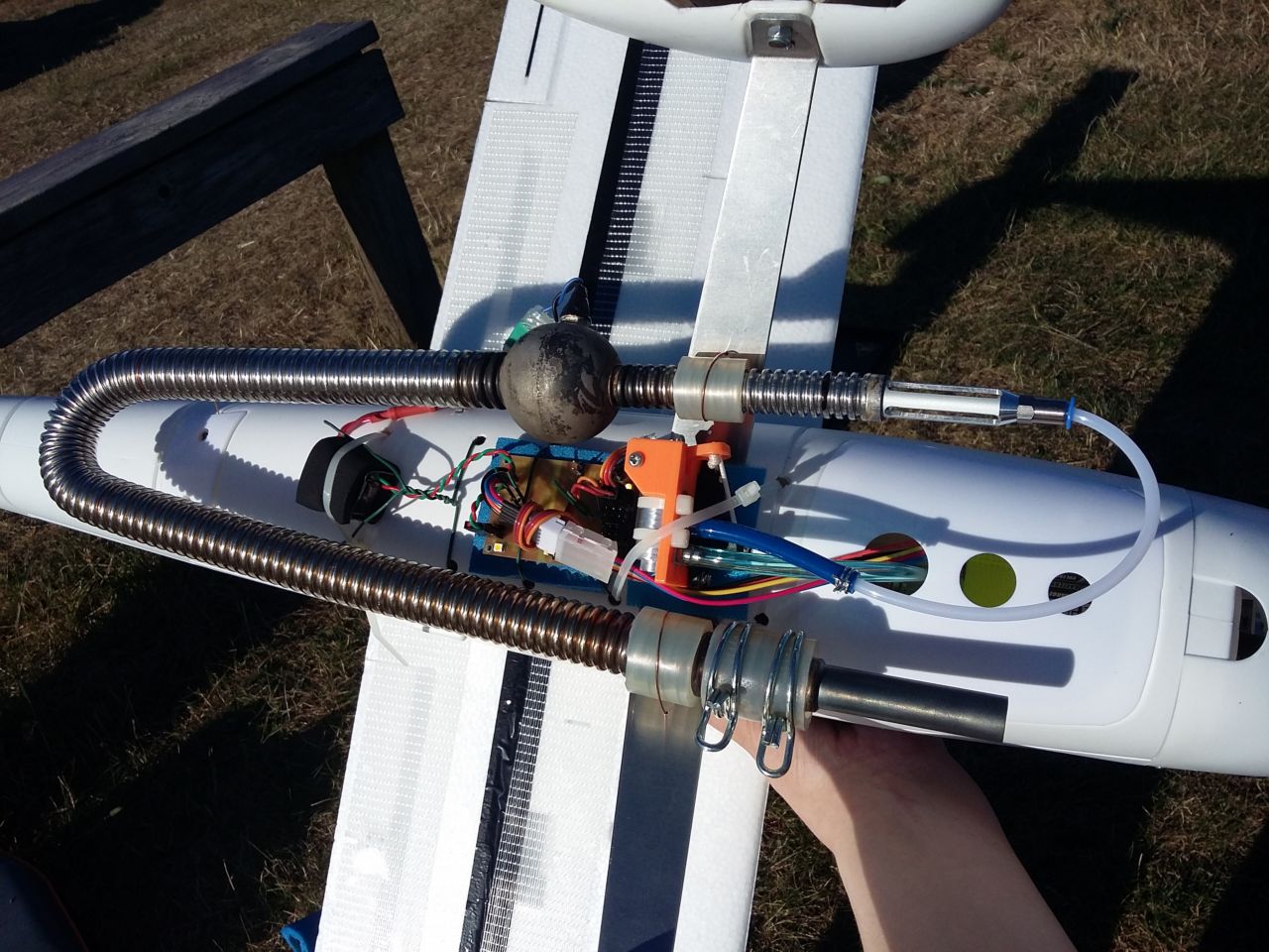

It has been quite some time since I last updated this thread, sorry about that. But there is not much to tell.
I'm still trying to make the sound cannon work on the plane in the air. I'm sure it's an aerodynamic issue regarding air intake and the forward pointing barrel.
The plane keeps setting me back. It seems like for every time I fly the plane for testing, something breaks. First it was my homemade exhaust. Since it broke and also decreased the engine power a bit, I made a new and smaller exhaust, which works OK but it decreases the power even more, but it works.

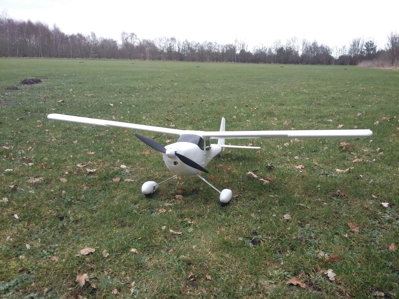

I'm currently building a second full metal cannon which I want to mount on another plane, a smaller and more simple plane, one I actually got just for this purpose. It's with an electric motor, foam wings and plastic fuselage. It's very lightweight but I have recently tested it's ability to carry a dummy load of 600g. with no issues so it should be able to carry the sound cannon but at a slower airspeed.
The plan is to mount the cannon on the belly of the plane and put the propane canister inside the fuselage. Then I have more freedom to change the aerodynamics around the air intake and barrel because it is easy accessible and I can 3D print some shapes.
I still have my successful in-air experiment from earlier to look back upon, which is basically what I'm trying to reproduce now with the all metal cannon but on a more weight-carrying-capable plane.
The picture attached is the plane I'm going to do the next tests with.
Sound cannon has now been mounted on the test plane. During only 1 evening of testing, I found the sweet spot that generates loud bangs. More testing is planned to optimize rate of fire and testing shapes that better resembles the bigger plane installation.
