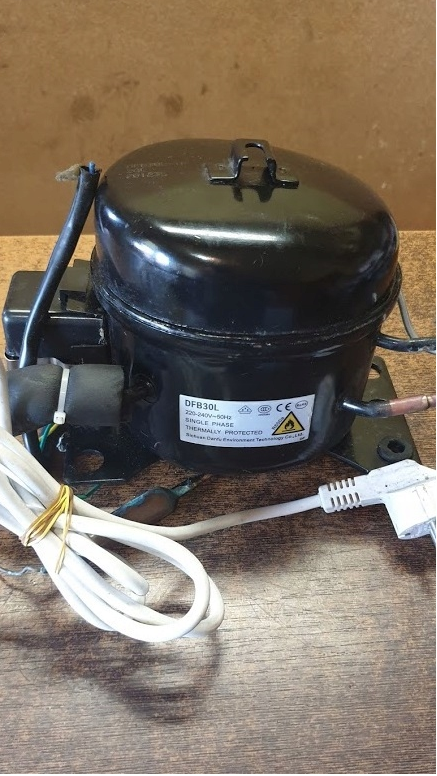

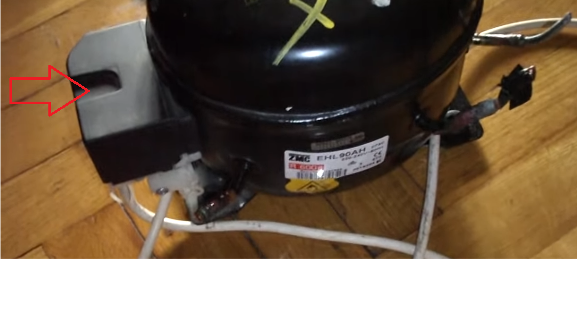

Thu May 16, 2019 1:50 pm
Will this go to 20 bar maybe? Its new

Tue May 21, 2019 4:56 am
Yes you should have no problem getting to at least 25 bar if you set it up like the instructables video.
Remember to throw in some lubricant every now and then, these are designed to work as closed systems so if you open them up wear will eventually become a problem. Some sort of humidity absorption at the inlet is also a good idea.

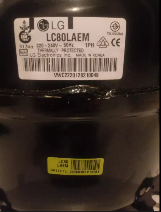

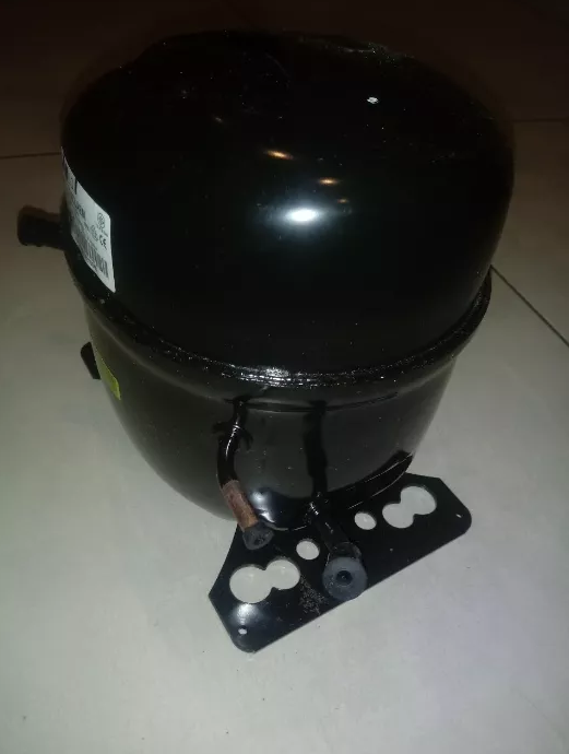

Tue May 21, 2019 7:06 am
So this LG compressor will be good? I dont see any eletronics on him

Tue May 21, 2019 7:42 am
It doesn't really matter since you're going to have to modify the circuit anyway.
look at the instructables link, it should be clear.

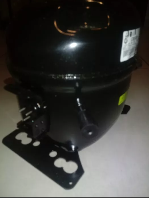

Tue May 21, 2019 7:58 am
So any electronics will be not problem in this LQ compressor? I dont see on this compressor any box like on others.

Wed May 22, 2019 5:49 am
The box is usually just covering the connections, as long as it's functional you shouldn't have a problem.
