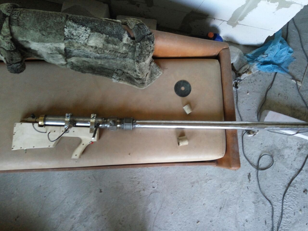

After two monthes i finaly made my first hybrid gun. It took so long because of the lack of money and knowledge. It's not fully finished yet but it already shoots.
Specs:
Chamber – 44cm of 2" steel pipe with welded in threaded fitting for a sparkplug. Walls are 3mm thick.
Barrels – 100cm 50mm barrel and 100cm 42mm barrel.
Ignition – originally it's been a chinese high voltage module but build in multiplier(not sure that i call it right) broke, so i had to cut it off and ask my dad to replace it with a bulky multiplier from an old TV and make a power supply for it(will switch to accumulators soon). Spark jumps 20-25mm in the open air.
The setup is bulky but when i finish the gun it will be more compact and build into the stock.
Sparkplug – car sparkplug. To adapt it to 1/2" fitting i took a 1/2" brass plug, drilled a hole in it, threaded a sparkplug into it. Then smeared a brass plug with acid from the inside and poured a molten tin into it. Basicly it is a homemade bushing, the sparkplug can be threaded out if i need. Originally it leaked, but i took it out, wrapped teflon tape arround it and threaded back in.
Valve – burst disk held by massive 2" union that i bought on the local market for 9$. Union has no threads, so it is welded to the chamber.
Metering – volumetric. I am using a 9 bar freon gauge. Metering pipe is attached to the setup.
Mixes – tested up to 5x, want to go to 7x but i am not sure that it is safe. Do you think it can handle it?
Ammo – wax slugs, wood slugs, saboted nails, vegetables.
Energy and velocity – HGDT predicts 2226 joules at 193 m/s with 120 gram projectile and 100cm long 42mm barrel at 5x mix. I will try to chrony it soon.
All the welding is done by my dad.
As i said it is not fully completed. I will make a stock for it soon, so i can shoot it as a handheld. Also i will clean up all the rust from the chamber and the barrels to make it look nicer. Maybe i will buy some pvc pipe and make a barrel out of it, because these steel barrels are too heavy.
Special thanks to keks2033, he have been helping me all the time. Also thanks to JSR for answering to my first topic with qiestions.
Hope you like it!
Questions, suggestions and reasonable criticism are appreciated!

Here is a better picture of the gun and pictures of the ignition setup. Now the union has a piece of thread welded on for the barrel attachment, but this picture was made before.

You will have a very good weapon. :) In general, everything looks solid, but I do not know if it is advisable to use a PVC firing barrel. I would continue with a steel barrel because it handles quite high pressures in this element. Consider an occasional traffic jam, for any unforeseen event, and the barrel must withstand these conditions well. For the subject of the ignition, with a simple piezo igniter, of those used in stoves or water heaters, it is enough to ignite a hybrid of up to 9x in my experience. Jack has made it work up to 16x as I remember. :roll:

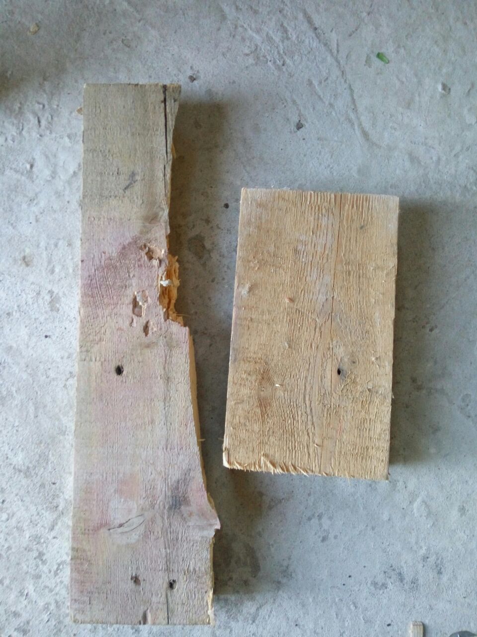

I am cutting burst disks out of aluminum beer cans and milk cartons. I use 3 layers at 5x mix. Also tested with 3 layers at 6x today. Damage is imressive. 90 gram wax slug with 16mm marbles busted 50mm wooden board at 6x. Also got a chrony result with saboted 30mm steel ball – 190m/s. Ball together with a sabot had a weight of 131 gram. Part of the sabot(piece of cardboard tube) stopped right at the end of the barrel, so lets say that the chronied part had 121 grams of weight. Not bad i think. 109 gram wax slug with stones chronied at 181m/s at 6x. I think something confused the chrony, because 6x can not be slower than 5x. At 6x the recoil moves gun 50-60cm back. Anyway, i am quite impressed with power of the hybrid gun. Now, when i've played with it a little, i am going to finish it.
50mm board shot with marble wax slug at 6x. Piece of the similar board on the right for reference
Wax slug with stones against 40mm door at 6x
50mm board behind the door

Vadim wrote:I think something confused the chrony, because 6x can not be slower than 5x.
Could it be that the slug is disintegrating in the barrel?

Moonbogg wrote:Well done! Looks like a good, strong hybrid cannon. I see your spark plug sits outside the main chamber area and it still works good. That's good to see. I was wondering if it had to be way inside the chamber area but I guess its fine sitting outside. That's a relief for me regarding my own future use of spark plugs. Good to know. Cannon looks powerful!
Thank you!
jackssmirkingrevenge wrote:Could it be that the slug is disintegrating in the barrel?
Yes, it could happen.
jackssmirkingrevenge wrote:Some videos would be nice ;)
I will make a video when i finish the gun. Maybe even this week, if everything goes nice.

It is finished now!
Video will be soon.

Lovely! Just need to stain that wooden stock and you have yourself some perfect post-apocalyptic chic :D
