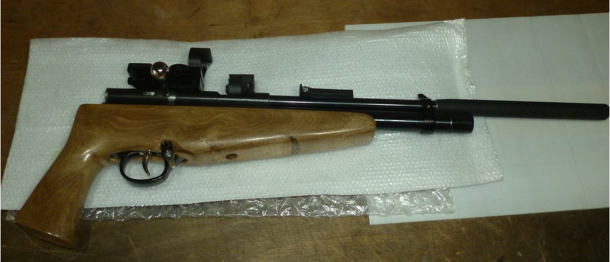

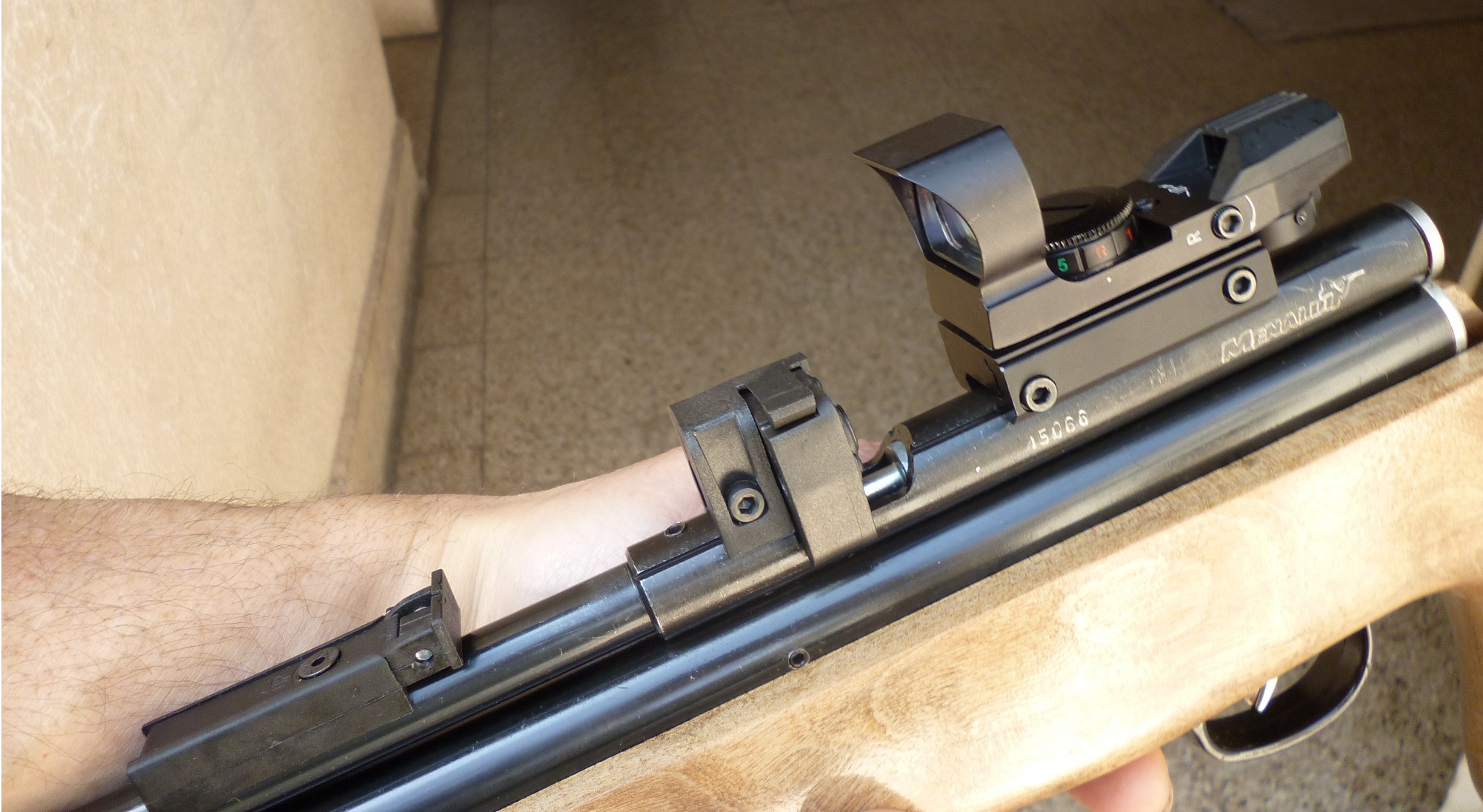

In the end I bought the red dot sight and installed it on the co2 gun. It is a Chinese sight, but it works well to play a little. It is made of non-plastic aluminum and the regulator is about 15 meters away. Quick to focus the objective, much more than with the open system of rise and point that the weapon brings. I just wanted to show you, although I have not manufactured anything of this weapon.

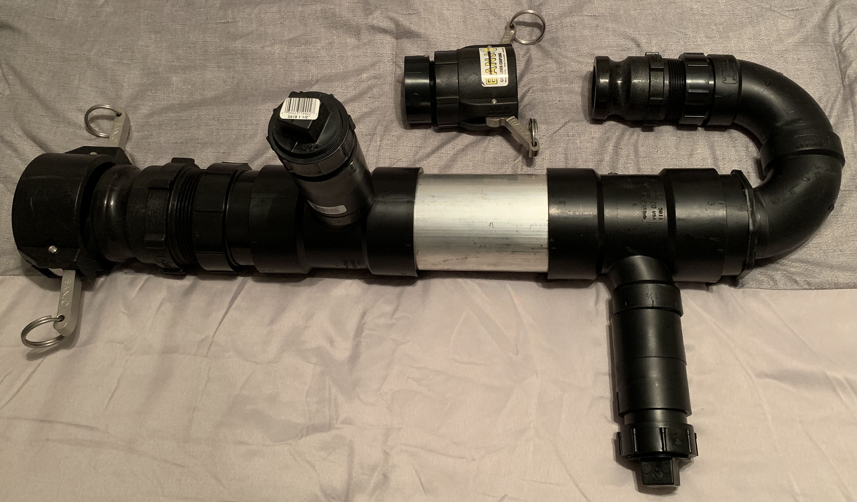

Winter is coming.

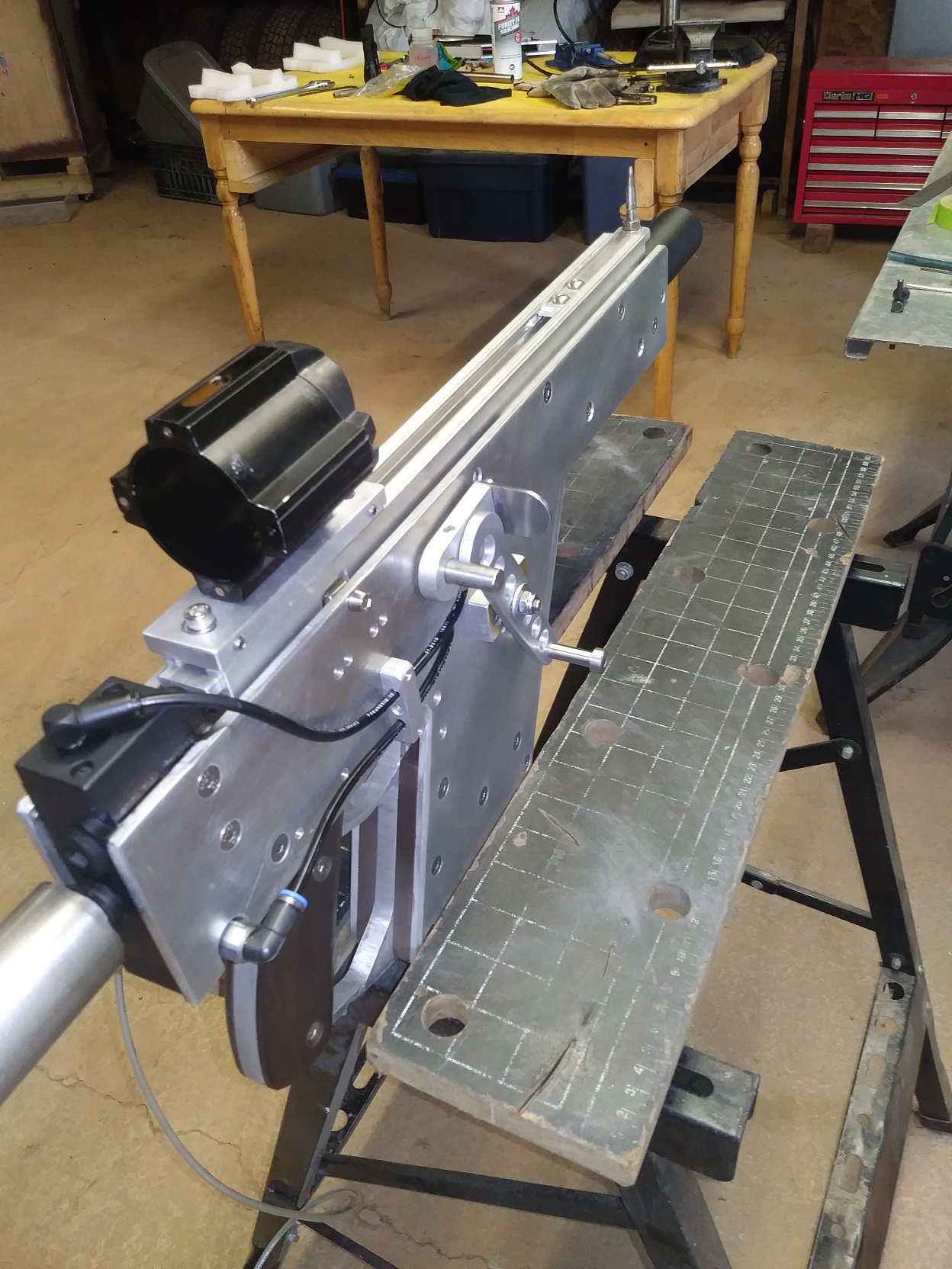

So we're going with solid-core ABS and aluminum for this build.
Obviously a mock-up, got some electronics work to do.

I thought by now I'd understand how a combustion works, but I can't figure out why there are two camlocks on this thing. Also, is that an aluminum section in the middle? I have a soft spot for combustion cannons. Let's get some details on this creation...
Posts: 3643
Been thanked: 62 times
Fri Oct 18, 2019 4:45 am
jackssmirkingrevenge wrote:He's back at it :) anything of note or just scratching that itch?
Mainly just scratching an itch. Have some bigger plans but I need a bigger workspace.
Moonbogg wrote:I thought by now I'd understand how a combustion works, but I can't figure out why there are two camlocks on this thing. Also, is that an aluminum section in the middle? I have a soft spot for combustion cannons. Let's get some details on this creation...
Camlocks are just faster than threads. I don't plan on having to remove the 3" "endcap" one during normal operation, but it's there anyway. The aluminum section in the middle is because the only ABS I can find (even online) is cellular core.

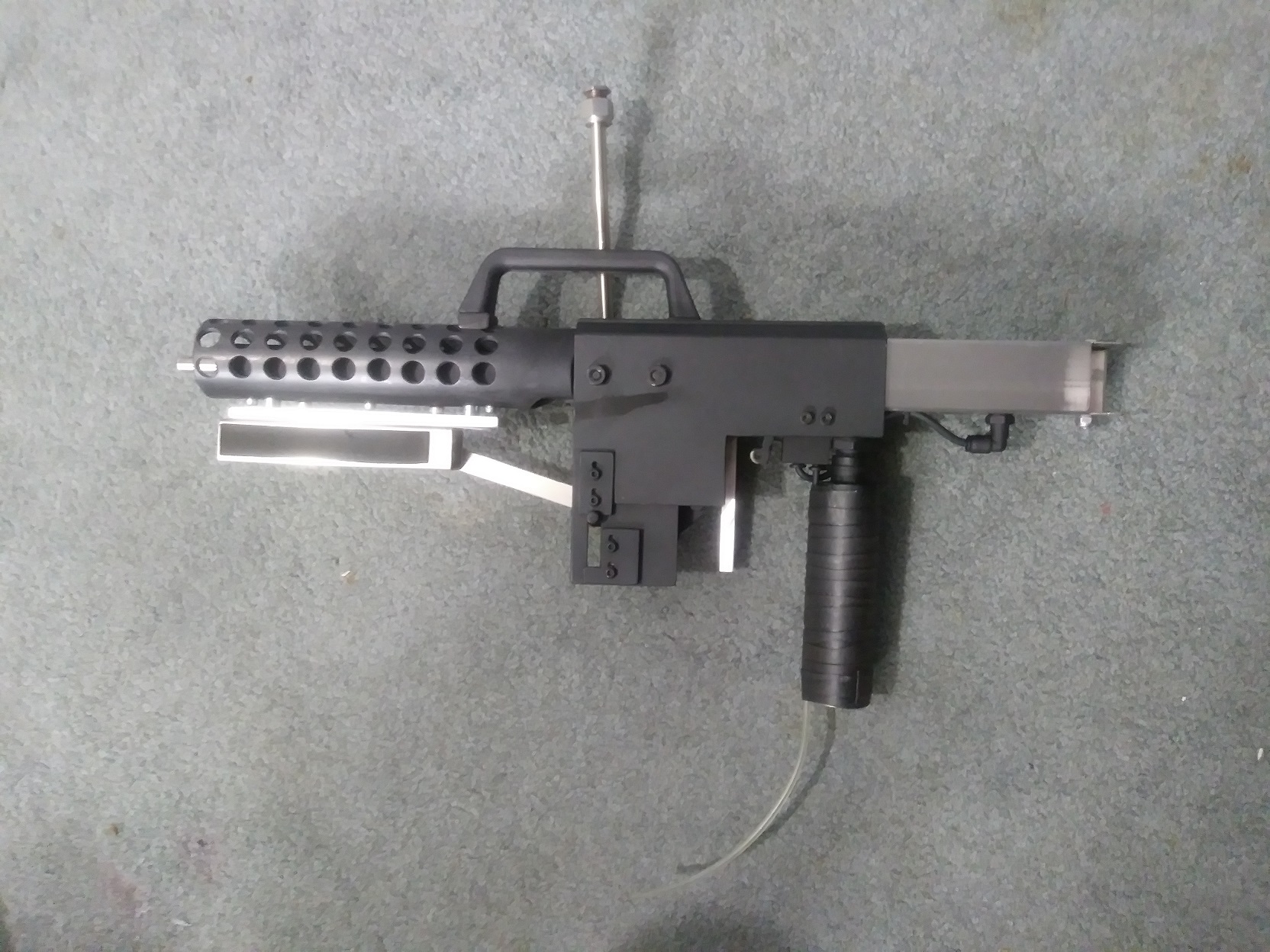

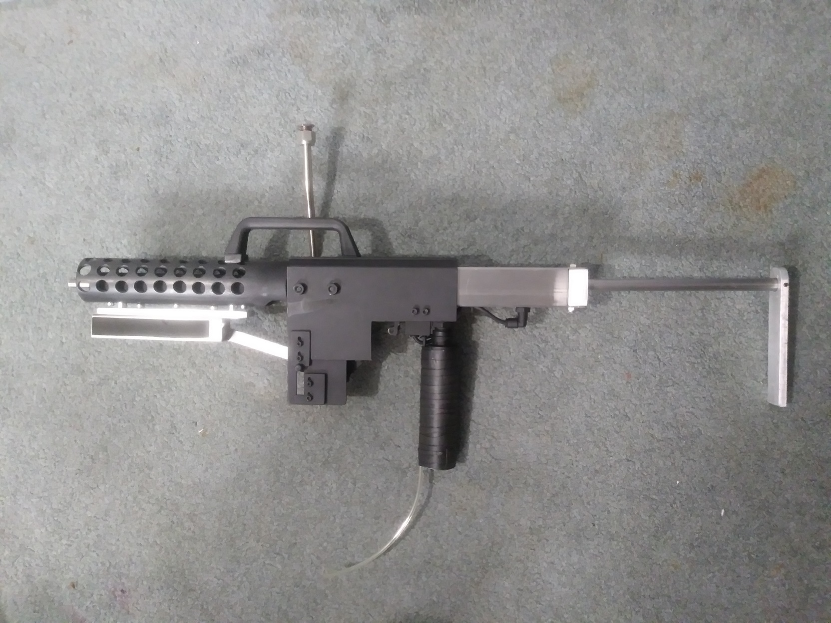

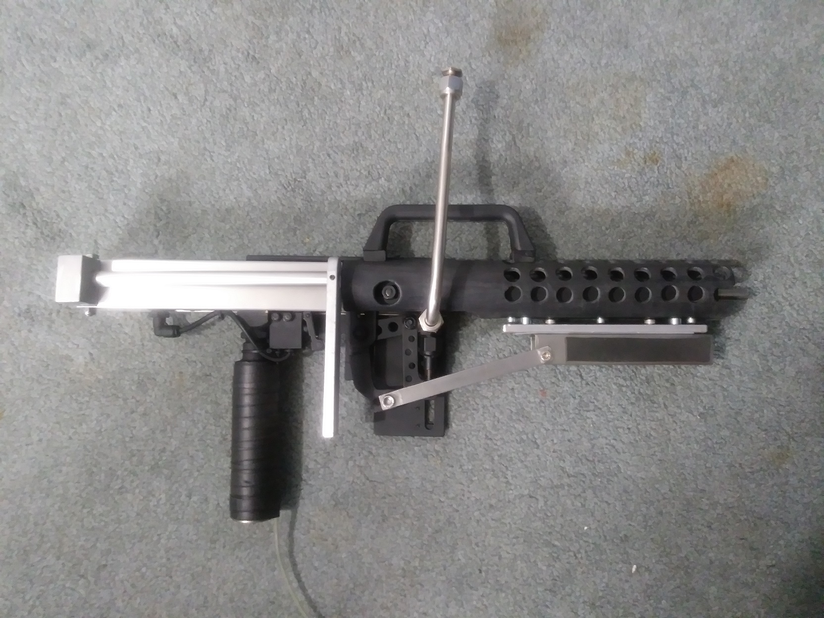

I haven't been doing much lately, sort of got into building bikes :shock:
I have turned the BFG into a MFG, cut down the barrel , removed all the semi auto bits, cut the body down a bit and now using a diiferent gravity fed mag which holds 20 BBs :D
Started making a folding stock for the pump action, because folding stocks :D just got to finish the butt plate.

Whoa, that thing looks awesome. Looks like a sub machine gun, lol.

That's this one :P

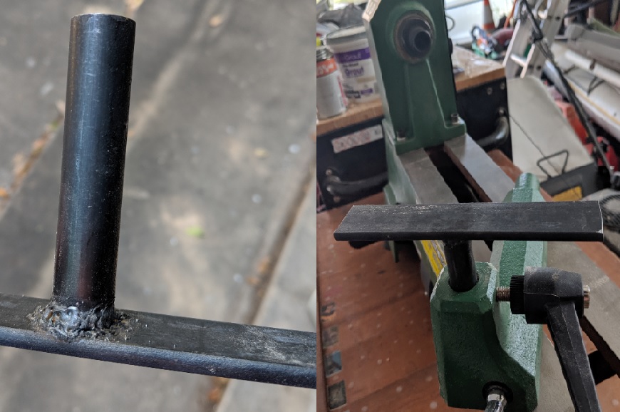

Got some practice with the welder by making a tool for the lathe. I've been needing a tool rest more suited towards the carbide tooling I use so I welded this together. The welds have really bad porosity but I believe that is because I was holding the gun at the wrong angle and I wasn't moving consistently enough.
Either way, it works and I'm getting closer to welding spud guns together!
