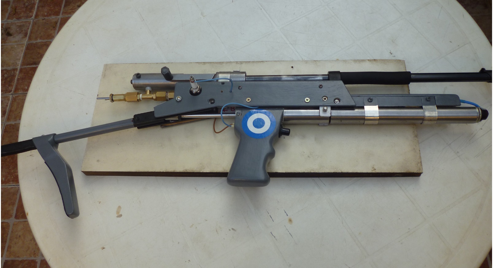

This is a project called "Armadas 1500 II". It is a weapon that works with an integrated air pump, it is a single shot, hybrid that precompresses at 8X - 10X.
The firing barrel is with 12 microgrooves, caliber .25 and fires common pellets. The inverted bolt is made of 1045 steel, the combustion chamber is approximately 20 ml. It has quite a bit of punch, going through 4 cans cleanly at 8X, with only 4 pumps.
It is an evolution of the previous ones, because it has more performance, 4 or 5 pumps are enough to compress the mixture and fire.
The dosing system is the standard one that I designed, and it works very well. Accuracy is excellent.
I used a motorcycle spark plug, screwed into the combustion chamber which makes it fire safely. The lighter is piezoelectric from the big ones.
The main valve is of the o'ring and ball type, which works excellent (it is the "captive ball" valve). The o-ring lasts about 150 - 180 shots before being replaced, which is easy, without having to remove too much.
The front tube houses the small liquid butane gas tank, and has its manually operated valve (pressed with the finger), to introduce the gas to the dosing system, about 6ml.
The sequence of operation is simple: You close the valve, place the pellets in the chamber, introduce the butane and give 4 pumps. The pumping lever, in this case the rear, includes the shoulder rest.
The ball valve - o'ring, is closed by pressing the small stem that can be seen on the back of the gun.

Sick! Looks very well put together. Inspiring actually!
Very clean work, nice "proper" evolution after all that prototyping...
I like the markings too, although perhaps it's more of a Fuerza Aerea (+Butanea) Argentina sort of equipment

Hi Jack!! Oh yes, I'm going to change the brand as you suggestjackssmirkingrevenge wrote: Thu Jun 16, 2022 9:14 am Very clean work, nice "proper" evolution after all that prototyping...
I like the markings too, although perhaps it's more of a Fuerza Aerea (+Butanea) Argentina sort of equipment![]()
Is it my impression or did you use balsa wood in the construction?
You can always tell when a spudder is also interested in model aircraft

Not in this case because the gun is a bit heavy about 3.4kg... I used 3mm tri-ply wood with a layer of thin fiberglass on the inner side, and screwed to the metal. In other models yes, I have used hard balsa because the weapon is very light.

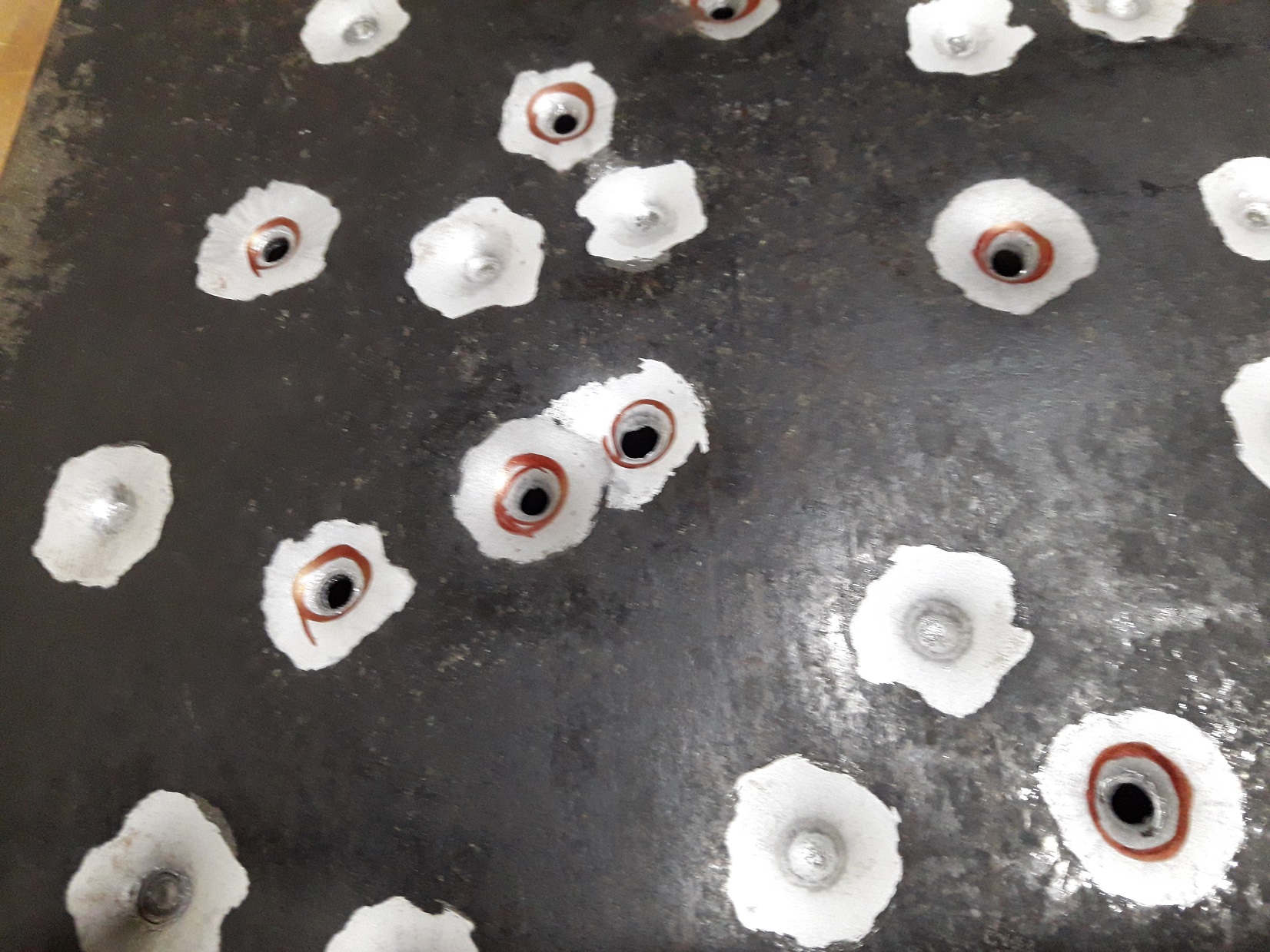

I am using 33 gr .25 caliber pellet. The force of the shot is quite important, at 9X, I can pierce 0,7 mm sheet steel. mm sheet steel.

That's quite impressive for lead pellets to be honest.I can pierce 0,7 mm sheet steel
Have you tried with more than two layers of foil?

No, I'm just using the gun with two rupture discs. Surely you can break three, with a little more precompression load, I estimate with 10 - 11X. At present it is set to 9X. I think that with the energy he currently has it is enough to play at home, without a doubt, with more pressure he will become more dangerous.jackssmirkingrevenge wrote: Tue Aug 09, 2022 7:02 pmThat's quite impressive for lead pellets to be honest.I can pierce 0,7 mm sheet steel
This model can shoot with 5 or 6 pumps, which is two power levels. Despite being only a pump difference is noticeable when shooting.
The only thing that doesn't convince me is that the "skirt" of the pellet is "welded" to the target plate, it doesn't pass, only the "head" of the pellet passes to the other side... look at the photo.
