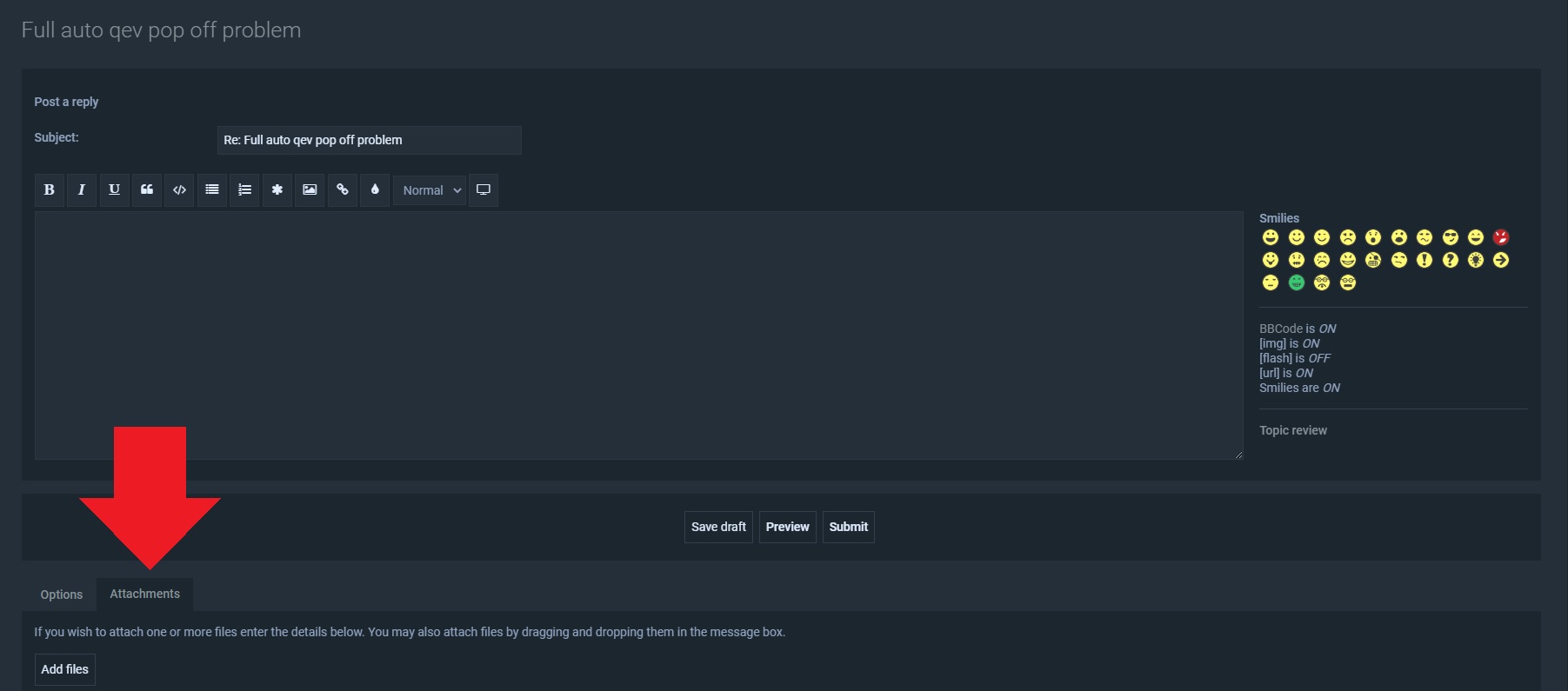

How do you post pictures, it will be simplier to show my setup. My pop off valve is actually similar to yours expect it's shorter. The problem can also be the spring in the Qev, your spring look softer than mine. You said before you have replaced the piston with a delrin disk, does this means full auto won't work with the regular piston with a hole?
Use the "attachment" tab in the "full editor & preview" reply window:
