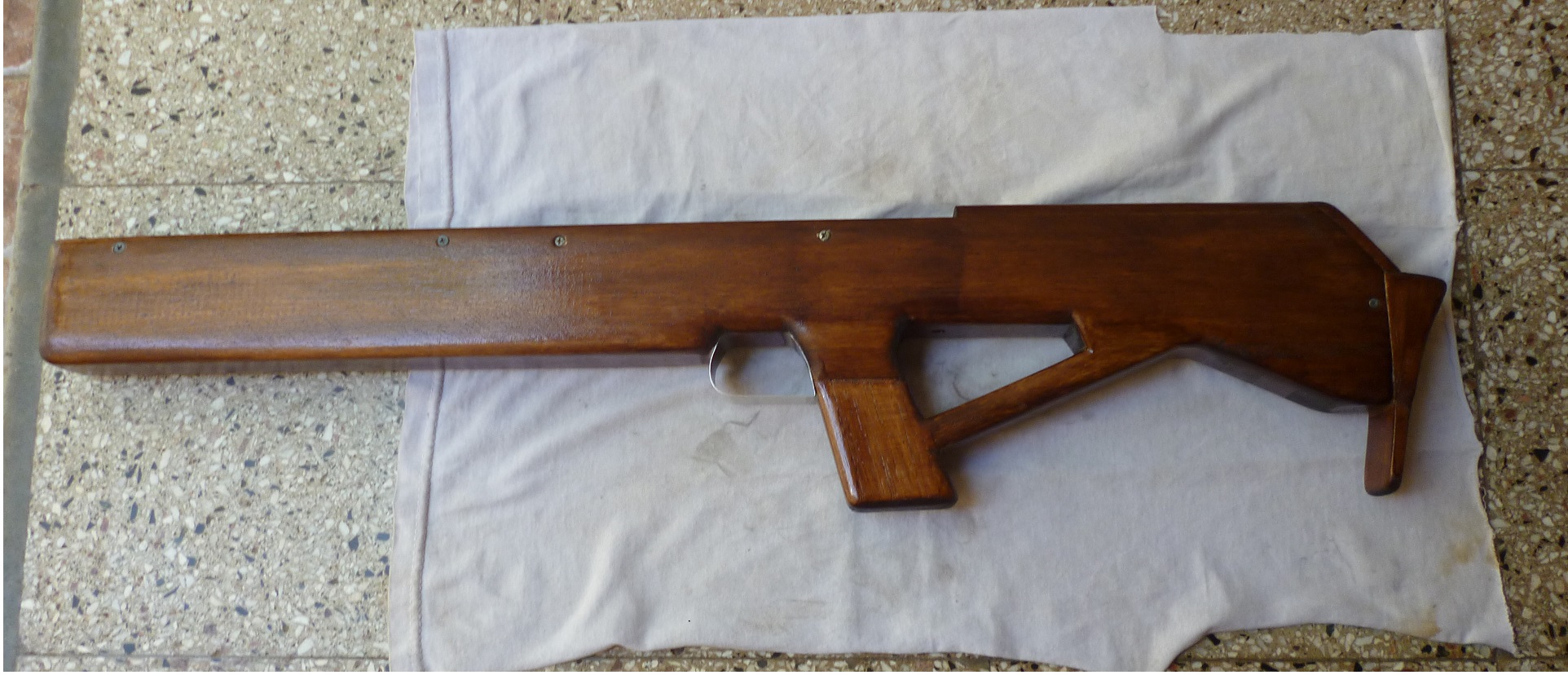

I built the hybrid's wooden stock, I think it looked nice.
I also finished everything about the machine itself. In the photos you can see the parts, the .25 caliber barrel, the bolt system, the piston valve with automatic pilot opening and closing of the pilot, which I described in previous posts, and the combustion chamber, which can be disassembled and use another, (to test - play). It is a modular design.
The combustion chamber has a useful volume of about 30 cm3. I am missing in the future, to assemble all the parts.
