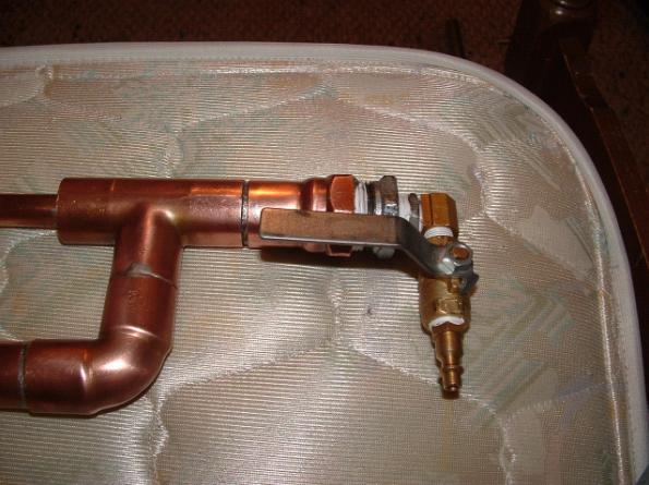

This is a copper piston-valved marble gun I made in response to lowering temperatures. The chamber is 1x36" type M copper tubing, and the barrel is 1/2x48" type M copper tubing. Marbles fit REALLY well in this pipe. The average diameter of the marbles I've measured has so far been .566". The inside diameter of this tubing is .569". There were little dings in the barrel from construction, and I actually had to use a ramrod to get a marble down to the bottom for the first two or three shots. Now, they slide down, (usually), and then take a while to do it.
The power I've experienced when shooting this gun is awe-inspiring. I shot a marble almost clear through a paperback book, (video at the bottom), and blanks sound like a .22 CB round going off, (if anybody here doesn't know, the CB rounds are the shorter, quieter of the .22 rounds).
The valve is a barrel sealing tee valve. I made the piston by sharpening the end of a scrap length of 1" tubing and punching out a few 1/8" neoprene disks to make up the back centering plug and the front sealing face. I originally had some problems with the piston not sealing against the back of the barrel, but now it seals perfectly. The piston seal inside it's carriage aint to shabby either. I can pilot it by only halfway opening the 1/4" ball valve, with respectable power still.
Anyways, enough yip-yap, and more pictures!
The money shot...
An overview of the launcher
A view of the pilot and fill assembly

What sort of pressure are you operating it at? I dont see a schrader valve anywhere. I take it you're charging it via the ball valve?
I usually charge er to around 120 PSIG through the male quick-disconnect on the ball valve, yes.
