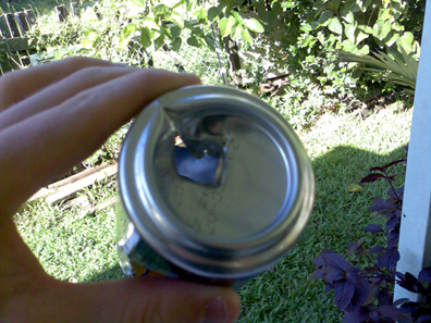

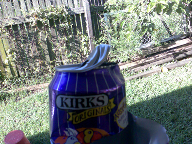

Hey guys this is my 1st Pnuematic cannon. It's a very cheap somewhat Ghetto-ish' looking Marble Cannon. I use a 25mm Ball Valve, a 1.5L Soda Bottle, a 1m length of Irrigation pipe and a Tubeless Tire Valve. I pump it up to 110psi and it's completely air tight. not one leak. Dont worry, I have been pumping up these sorta bottles for a long long time and have never had a blow out. I should be upgrading to a Sprinker Irrigation Valve with a Pull-pin Pressure Relief Valve as the trigger pretty soon. I've got alot of bills to pay so it's them 1st and the cannon 2nd =P Thanks alot for looking!

Nice job, rips up cans nicely. I guess you work with what you got! Measure the gerth of that soda bottle pumped up to 110 psi. I wanna know how fat it gets! lol!
