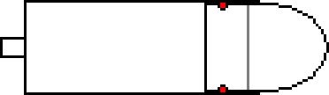

The problems, as already mentioned, with using a projectile sealing "valve" is that it needs to be strong enough to support a 10x mix, which may end up reaching around 150psi. Obviously, this would probably easier to reset each cartridge, but a way needs to be figured out to allow the projectile to support such a pressure.
This brings up the use of some sort of detent. Maybe something along the lines similar to a quick connect?

Why does the projectile have to be a ball bearing? Why can't it be homemade, such as out of PVC? It would make it a lot cheaper.
Here is a thought for a projectile sealing cartridge.  The red dots are small bearings or something to rest in a groove in the projectile to hold it in place and the gray line is an o-ring.
