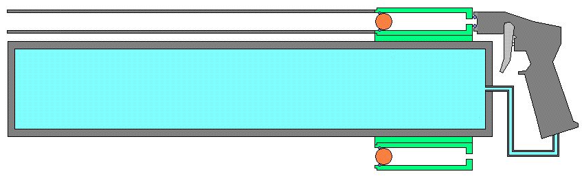

My First Pressure gun ever. Over/Under Design, need help.
mlz3000 wrote:Alright, that's what I thought, thanks.
While we're kind of on the topic though, what's the biggest piston valve one could make where a blowgun would be sufficient as a pilot valve? Or would it just almost always better to use a ball valve?
Would a sprinkler valve modded with a blowgun perform appreciably better than one with a blowgun?
To answer that one simply has to understand how a piston valve works. It remains closed until the pressure in the pilot area drops enough to unbalance it so the force holding it closed is less than the force trying to open it.
In order to get the pilot area pressure low enough, the pilot valve vents that area. The larger the volume and the lower the flow of the pilot valve, the longer this takes.
If the piston has some leakage either intentionally or accidentally due to an EQ port or piston blow by, air is added to the pilot area at the same time you are trying to let it out. If the leakage is large, the blowgun will be unable to drop the pressure enough to unbalance the piston and the chamber will bleed out to the pilot without firing.
If the leakage is sealed or very small, a small blowgun will be able to pilot very large valves, but it may take a while to vent the pilot area low enough to fire.
Because most piston valves leak some between the chamber and pilot area, taking a long time to vent the pilot area provides longer time for air to leak out of the chamber into the pilot area resulting in the pressure dropping in the chamber before the cannon fires. For this reason it is a good idea to use a faster flowing pilot valve. Less pressure is lost from the chamber before it fires.
I hope this answers the question.
And the slower the less power because the piston won't open very quickly, less air will flow out the barrel and then you get more of a continuous stream as apposed to a large, Quick blast. Correct? :?

Yukondano2 wrote:And the slower the less power because the piston won't open very quickly, less air will flow out the barrel and then you get more of a continuous stream as apposed to a large, Quick blast. Correct?
Not really. As soon as the front of the piston lifts off the sealing face it experiences a force pushing it back equal to the area across the "sealed" diameter of the piston times the pressure. Once the piston "cracks," it moves back with such force that the flow out the pilot valve becomes negligible. Most of the loss from a poor pilot valve comes from the delay and the loss in chamber pressure before the piston unseals. Keep in mind that the piston doesn't begin to move as soon as you open the pilot valve, which is just there to get the piston moving. Once the piston is moving, other forces take over.
No advantage to multiple chambers, just an abnormally high C:B ratio, and since the chamber volume is so tiny anyways, it's not much more effort to pump.
A multiple shot design doesn't require multiple valves necessarily. You could set it up like a grenade launcher, where the grenades are a cylinder of compressed air, and you breech-load from a separate magazine.

So is there any DISADVANTAGE to multiple chambers? Because again, Its for looks and compactness. However if it reduces functionality then i'm worried.
saefroch wrote: A multiple shot design doesn't require multiple valves necessarily. You could set it up like a grenade launcher, where the grenades are a cylinder of compressed air, and you breech-load from a separate magazine.
I don't follow. What do you mean? How do I separate the airflow from each cylinder? My idea wasn't to have multiple shots but now it occurs to me that MIGHT be a good idea. In order to be true to the original I would be using Six Canisters. I'm assuming this would be manual, so I would do something like reconnect the canister to the gun by like a hose? Of course If i do that then its going to work terribly going through such a small space. I wish I could just have it rotate and fire instead. A breech obviously wouldn't work unless I somehow cut the flow, closed the breech, and opened the flow. Of course at that point I would ALREADY be using a valve on each chamber.

Here's a conceptual drawing of how one could achieve multiple shots from a single chamber with a spring loaded piston valve:
Note that the piston is not completely airtight, meaning air is free to flow back into the pilot chamber after each shot.
You could combine this system with a revolving magazine for reloading, maybe coaxial with the chamber.

There is NO disadvantage to having "multiple" chambers, like on my trident. It's actually modeled as one 28" long .495" inner diameter chamber.
If you were to use multiple cylinders like on the grenade launcher, you'd have each pre-pressurized and sealed. As you fire one, the next one slides into position and you use some method to unseal it, maybe a check valve where you simply push in on the sealing face of the check valve to force it open. Rather like JSR's second diagram, except with the barrel in the middle and the chambers on the outside. I wouldn't advise trying to build pneumatic cartridge system (here JSR and I are talking about the same thing) before you've built a piston valve though...
2-D Design software? I actually just use autoshapes in PowerPoint, I know some people use paint. There's really no need for high-tech 2-D design, just use what you have available.
