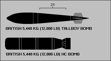

Ragnarok wrote:It achieved that by virtue of its mass and sectional density, not any particular aerodynamic mastery.
If you figure it, drag increases with the cross sectional area, mass with the volume... hence, Square/Cube law, bigger objects have a higher terminal velocity than smaller objects.
I disagree, aerodynamics is certainly a factor. Otherwise, the 12,000lb HC bomb shape (see attached diagram) would have been adequate. The Tallboy's thicker steel body of course helps with penetration once it hits the ground but not with acceleration the HC and Tallboy have similar weights and diameters and therefore cross-sectional density.

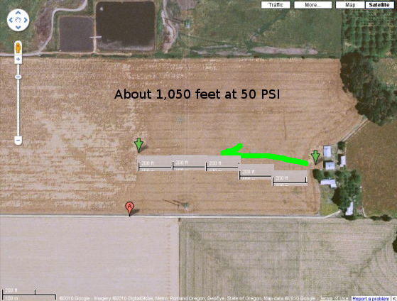

I started to test golf ball range starting with low pressure with one of my launchers when I had the chance to use a large farm. The test ended when we got rained out at 50 PSI.
Hopefully someday, I'll be able to continue and work up to 100 PSI. We were able to find the golfballs shot with 50 PSI air.

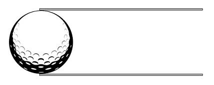

According to NASA it seems it's a better aerodynamic shape.Labtecpower wrote:(a golf ball with a cardboard tube strapped to the back)

I think a sphere is more aerodynamic than my bullet, as it tumbled quite a lot. It made a sound similar to a jet fighter.. the sound of inefficience
You mean like the attachment? Technically it should fly straight...Labtecpower wrote:I think a sphere is more aerodynamic than my bullet, as it tumbled quite a lot.
On afterburner, yes... but nonetheless impressiveIt made a sound similar to a jet fighter.. the sound of inefficiency
